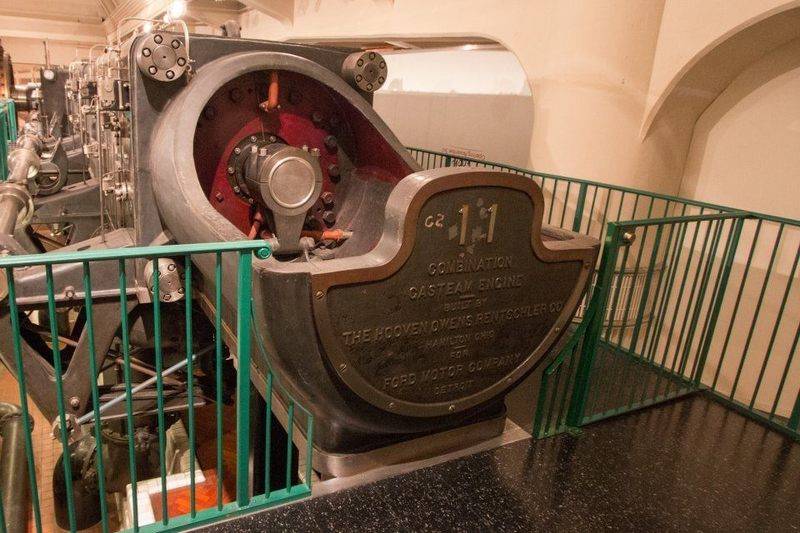

Gas-Steam engines are what powered Henry Ford's Highland Park Model T plant. There were nine 6,000 horsepower engines in the power plant at Highland Park.Instead of me trying to explain them, you can read more at the Ford Oral Histories section where Hugh Dolan tells how it worked. My grandfather was the draftsman to Edward Gray who invented and designed these engines.

In power generation STAG (steam turbine and gas) are common.
Gasses from the gas turbine go to a waste heat boiler which makes steam for a steam returning.
So the answer is yes if your vehicle is the size of Titanic or larger.
