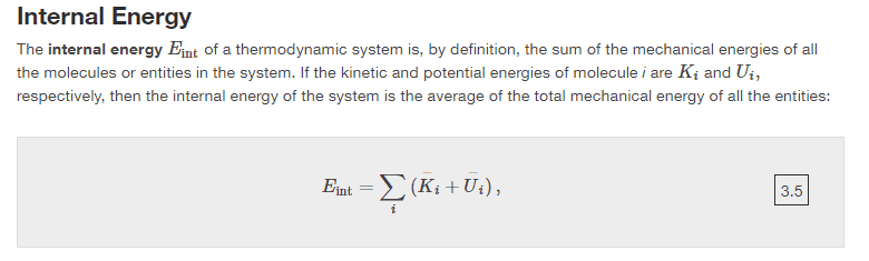

They say internal energy is the sum of the all the mechanical energies of each particle in within the thermodynamic system, however, they then define internal energy differently using the average mechanical energy for all particles within the system (Pink equation). Does someone please know why they did that?
Many thanks!

There is actually bars,
I think the highlighter might have made them hard to see.
Sorry I don't have any common sense since I am do not have any other experience with an equation of internal energy. What internal energy equation do you use?
Many thanks!
It looks to me like a conflation of two expressions: ##E_{int}=\Sigma_{i=1}^N(K_i+U_i)=N(\bar K+\bar U)##.
But the opening sentence is wrong, it is not the sum of individual kinetic and potential energies.
For the KE, as is later clarified, the sum is over the KEs in the frame of reference of the common mass centre.
For potential energy, the sum over i makes no sense since individual molecules do not have PE. Internal PE resides in the forces between the molecules and the potential of those forces to do work. Further, this is distinct from PE involving external forces.
What is the book?

Couldn't ##U_i## be considered the amount of work needed to bring a given molecule from infinity to its present location, holding the locations of all other molecules at their present positions?
Likes member 731016
Yes, provided you make it ##\frac 12\Sigma U_i##.
