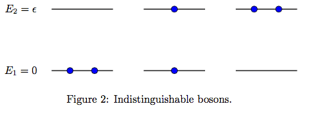

No, this is generally not true for indistinguishable particles as the following minimal example will demonstrate.
Consider a system consisting of two particles, each of which can be in one out of two possible one-particle-states with the energies ##E_1 = 0## and ##E_2 = \epsilon## respectively.
Case 1 (distinguishable and noninteracting particles)
The single-particle partition function is in this case given by \begin{align}z = 1 + e^{-\beta\epsilon}\end{align} and the total partition function is \begin{align}Z_\text{dist} &= 1 + 2e^{-\beta\epsilon} + e^{-2\beta\epsilon} \nonumber\\ &= \big(1+e^{-\beta\epsilon}\big)^2 \\ &= z^2\nonumber\end{align} as expected.
Case 2 (indistinguishable bosons)
The single-particle partition function is still given by (1). However, this time, the total partition function given by \begin{align}Z_\text{bosons} &= 1 + e^{-\beta\epsilon} + e^{-2\beta\epsilon} \nonumber\\ &\neq \frac{z^2}{2} \\ &= \frac{1}{2} + e^{-\beta\epsilon} + \frac{1}{2}e^{-2\beta\epsilon}\nonumber\end{align} as otherwise claimed.
Case 3 (indistinguishable fermions)
Likewise is the single-particle partition function also given (1). However, this is the total partition function given as \begin{align}Z_\text{fermions} &= e^{-\beta\epsilon} \nonumber\\ &\neq \frac{z^2}{2} \\ &= \frac{1}{2} + e^{-\beta\epsilon} + \frac{1}{2}e^{-2\beta\epsilon}.\nonumber\end{align}
Conclusion: Neither ##Z_\text{bosons}## nor ##Z_\text{fermions}## satisfy ##z^2/2##.
EDIT: Three pictures illustrating the above three cases.
