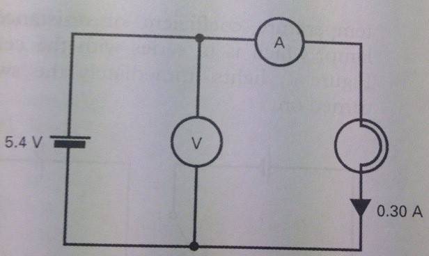

The battery in the circuit below has EMF 5.4 V and drives a current of 0.30 A through a lamp. The voltmeter reading is 4.8 V.
Explain why the voltmeter reading is less than the EMF of the cell.
Calculate values for (a) the internal resistance of the battery, and (b) the energy transformed per second in the lamp.
State two assumptions you made in order to complete these calculations.
Answers: (a) 2.0 Ω, (b) 1.44 W
2. The attempt at a solution
The voltmeter reading is less than the EMF of the cell because the EMF is a non-ideal power source that has internal resistance and therefore the output 4.8 V is lower than the input 5.4 V.
(a) E = I r + V → 5.4 V = 0.3 A * r + 4.8 V → r = 2 Ω.
(b) W = V I t = 4.8 V * 0.3 A * 1 s = 1.44 W.
I would assume that the ammeter has no resistance and therefore does not disturb the circuit. I would also assume that the voltmeter has infinite resistance and also does not disturb the circuit.
I am mostly unsure on the theory part. Is it correct? What's wrong?

It all looks correct to me.

It's not a matter of significant figures but rather of keeping track of units. Volts x Amps = Watts, and a Watt is a Joule per second. So Watts gives you energy per second, which is what was asked for.
If you multiply Watts by a time value (like your 1 s) then you end up with the energy delivered (or consumed) over that particular time span in joules, not joules per second. So what is being pointed out is that you should not have multiplied by the 1 s value as it makes the math incorrect unit-wise.

Okay. Just to be sure, the Watt is the name given to the unit group J/s (that is, joules per second). It is the rate at which energy is changing, also known as power. In fact the Joule is also a compounded unit! ##Joule = kg~m^2~s^{-2}##. Energy and power are such useful concepts that they were given their own unit names.

No. Watts is the answer. Energy per second, that's what you were asked to find. From the problem statement:
Note that it doesn't say "in one second", it says "per second". The nuances of precise technical language can be a bit tricky at times :smile:
