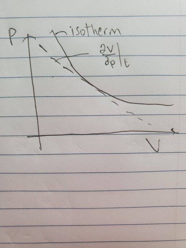

Here's a hint. Start out by drawing a short section of an isotherm on a PV diagram.

After reconsidering,I think it is actually an isothermal expansion since the slope ##\frac{\partial v}{\partial p}\big|_{t}## is multiplied by ##\frac{\partial \Gamma}{\partial v}\big|_{p}## ,which is along the ##x## direction.

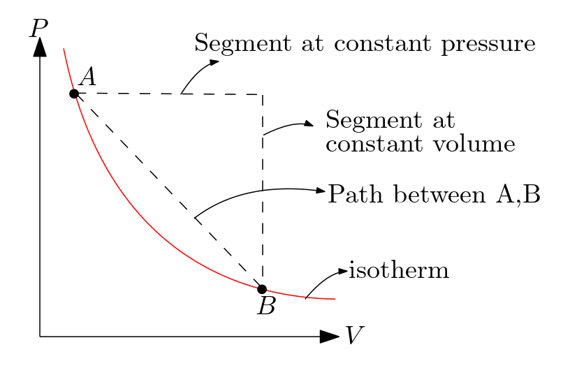

What they are looking for is two alternate paths connecting two adjacent point on the isotherm. One path is directly between the two points. The other has one segment at constant pressure and a second segment at constant volume. The diagram should show that the two alternate paths deliver the same change in gamma.
Likes PhysicsKush
I think I successfully illustrated what you described to me. If that is indeed correct, I'm very curious to know how how you were able to interpret the given PDE formula and come up with this conclusion, because I'm not able to do that. Thank you again sir.

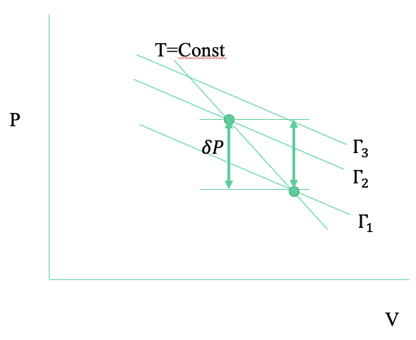

OK. I'm going to take another shot at this. On a PV diagram, show some lines of constant T, and some crossing lines of constant ##\Gamma=vp^2##. Then show the line for a change in ##\Gamma## along a line of constant T. I think that this will make more sense to you.
If we increase pressure by ##\delta P## at constant temperature, the function ##\Gamma## increases from ##\Gamma_1## to ##\Gamma_2##. But. if we increase pressure by ##\delta P## at constant volume, the function ##\Gamma## increases by more, from ##\Gamma_1## to ##\Gamma_3##. So, in the latter case, if we want to get the change and constant temperature, we need to add an additional term equal to ##\left(\frac{\partial V}{\partial P}\right)_T\left(\frac{\partial \Gamma}{\partial V}\right)_P\delta P=-(\Gamma_3-\Gamma_2)##
Likes PhysicsKush
WOW ! I think I understand now ,all the pieces are connecting together !
Thank you so much for having persisted with me throughtout this. Couldn't thank you enough sir.
