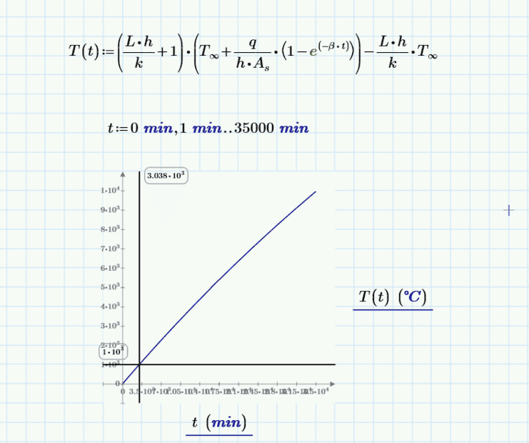

$$ q - h A_s ( T_s - T_{\infty} ) = M c_p \frac{dT}{dt} $$
##q## heat rate input ( kW)
##h## convection coefficient of surroundings air
##A_s## exterior wall surface area
##T_s## wall surface temp.
##T_{\infty}## enviroment/surroundings temp.
##T## is the instantaneous sand temp.
##M## mass of sand
##c_p## specific heat
##L## is wall thickness
##k## thermal conductivity of wall matherial
##\beta## is a time constant ## = \frac{h A_s}{ M c_p \left( \frac{Lh}{k} + 1 \right) }##
Solution (under stated assumptions) and 100 kW input:
Here are the parameter values:

So stop me If I've figured something wrong but you have a surplus of 3MWh over the span of 7 month ( 210 days). That means you have an average available input power of:
$$\bar{q} = \frac{ 3 \cdot 10^6 ~\text{W h}}{210~ \text{day}}\cdot \frac{1 ~\text{day}}{ 24 ~\text{h}} \approx 0.6 ~\text{kW} $$
Here is what the graph looks like for 0.6 kW.
Notice the asymptote at about 235 C. I wouldn't start digging yet...

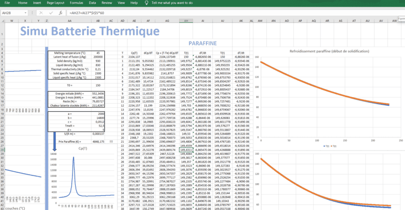

First simulation (conduction only) for paraffine/wax. With 4 ##m^3## of wax heated to 150°C, I initially store 550 kWh, I get 350 kWh 3 months later (63 % remaining, thanks to 210 kWh stored as latent heat) with a much more reasonnable insulation (no fire brick, 15 cm of rock wool and 15 cm of polyurethane). I had to model the wax apparent ##C_P## as $$C_P(T)=aT+ b + \frac{c}{d(T-T_{melt})^2+1}$$ (with the values of a, b, c and d as on the excel sheet below). This would amount to 200 kJ/kg of latent heat. And this would be much more encouraging than the sand (lower temperatures, far less insulation, plateau in the cooling thanks to the latent heat)
  • BatterieThermiqueSandWax.xlsx
Thank you for your simulation @erobz ! My own simulation was rather with 4 m^3 of sand (and the quantity of insulation for such a volume is already dissuasive !). No conduction loss in your differential model ?
The effects of conduction are hidden in ##T_s##. Because I'm ignoring the heat absorption by the wall itself, conduction is just an intermediary step to convection. My surface boundary condition (power balance) is given by:
$$ h A_s ( T_s - T_{\infty}) = k A_s \frac{T - T_s}{L} $$
That is solved for ##T_s## in terms of the sand temp ##T##, and subbed into the ODE.

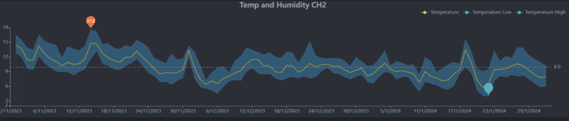

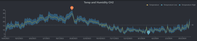

For the cooling phase what are the average temperatures the unburied sand battery would experience?
Over the last year, the annual average was 16°C (in a shaded box outside)
PaulMuadDib said:
Over the last year, the annual average was 16°C (in a shaded box outside) View attachment 343381
You are trying to store heat over the winter months though? Visually maybe 5 C?
Sorry @erobz, I misunderstood your question, the cooling phase will start from end of october to early febuary: mean temperature is 9.9°C during this period (while my underground garage stays around 13°C in a very stable manner from november to febuary)
