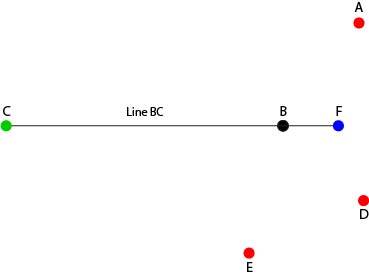

Hello,
I believe that this is the correct forum for this post but please let me know if otherwise.
I have the following data in R4,
Code:
id     x              y             z            a
B     -0.0700177      0.382249     -0.289338     0.00349957
A      1.13388        1.77602      -0.679365    -0.729256
D      3.97525       -0.0977321    -0.319119     0.864731
E     -2.78909        0.10647      -0.206478    -0.0550962
C    -35.0653177    -39.836051     23.355262     1.57447957
This data is roughly in the form of, though this is in R3,
I need to find the coordinates for point F that is on line BC and also in the plane of A,D,E.
Generally, I guess that I would find the equation of the plane and the equation of the line and then the simultaneous solution for both equations. To find the equation of a plane, I would find the normal to the plane by taking the cross product of vectors AD and AE. Since the cross product is only defined in R3 and R7, I can't do this for R4, or any other dimensions.
I have vectors from point B to all other points and also vectors from point A to points D and E but I'm not sure how any of that helps. I assume that you can construct the equation for a hyperplane using a matrix operation, but I that's about as far as I have got with this.
I will code up the solution in c++ when I have a working method so I could use the Eigen library to to matrix operations if that is necessary.
Suggestions would be appreciated.
LMHmedchem
Hi LMHmedchem,
I'm afraid that a plane determined by 3 points is not a hyperplane in 4D. We need 4 points to define a hyperplane.
Consider that if we have two 2D planes in 4D, that this is similar to two lines in 2D.
Two lines in 2D can be either parallel, intersect in 1 point, or coincide.
Similarly two 2D planes in 4D can either be parallel, intersect in 1 point, intersect in a line, or coincide.
In this case you are intersecting a line with a 2D plane in 4D.
In other words, it is likely (I didn't check yet) that there is no intersection at all, just like a point in 2D is unlikely to be part of a line.
Can you clarify if we are supposed to have a hyperplane after all?
Or do you otherwise have a reason to expect that there will be a single point of intersection?

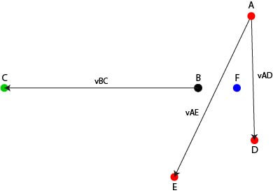

I am not entirely sure about this. In my understanding, providing the space is orthogonal (which it is in this case) any three points can be considered to lie in a Euclidean plane, regardless of the dimensionality of the point coordinates. I would define this plane as two vectors with their tail at one of the three points such as vAD and vAE in my example above. I called it a hyperplane because the dimensions of the points are R4.
You can calculate the distance between A and D as the magnitude of the vector vAD. You can take the dot product between vectors vAD and vAE and thus find the angle. All of these calculations work for R4 or higher as well as for R2 and R3. You cannot, of course, find the cross product after R3, but you can do other operations in the plane such as finding vector projections and rejections. I have seen here and there other methods for calculating the equation of a plane that do not involve plane normals.
Based on this, I was thinking that you should be able to find the intersection between the plane vAD,vAE and a line vBC as in my example above. I am assuming that vBC is not parallel to the plane or in the plane. I would think that there would have to be a single point of intersection if neither of those are true.
Am I thinking about this incorrectly?
LMHmedchem
That is not a hyperplane.
A hyperplane is a space that has one dimension less than the space it is contained in.
So in 4 dimensions a hyperplane is a 3-dimensional space.
It means that ADE is not a hyperplane but 'just' a plane.Anyway, let's see where we can get.
Let:
$$\mathbf v_1 = \mathbf D - \mathbf A\\ \mathbf v_2 = \mathbf E - \mathbf A\\ \mathbf v = \mathbf C - \mathbf B$$
and let $\boldsymbol \pi$ be the intersection point. That is, the projection of $\mathbf B$ in the direction of $\mathbf v$ onto the plane.
Then $\boldsymbol\pi$ must be $\mathbf A$ plus a linear combination of $\mathbf v_1$ and $\mathbf v_2$.
That is:
$$\boldsymbol \pi = \mathbf A + \lambda \mathbf v_1 + \mu \mathbf v_2 \tag 1$$
And we must also have that $\boldsymbol \pi$ is on the line BC.
That is:
$$\boldsymbol \pi = \mathbf B - \xi \mathbf v \tag 2$$
In other words:
$$\boldsymbol \pi = \mathbf A + \lambda \mathbf v_1 + \mu \mathbf v_2 =\mathbf B - \xi \mathbf v \quad\Rightarrow\quad
\lambda \mathbf v_1 + \mu \mathbf v_2 + \xi \mathbf v = \mathbf B - \mathbf A \quad\Rightarrow\quad
\begin{bmatrix}\mathbf v_1 & \mathbf v_2 & \mathbf v\end{bmatrix}\begin{bmatrix}\lambda \\ \mu \\ \xi\end{bmatrix} = \mathbf B - \mathbf A \tag 3
These are 4 equations with 3 unknowns, meaning the system is overdetermined.
This is expected and means that (3) will generally not have a solution.
The best we can do is to find the point on the line BC that is closest to the plane ADE.
Let $M = \begin{bmatrix}\mathbf v_1 & \mathbf v_2 & \mathbf v\end{bmatrix}$.
Then the easiest way to do that, is to apply the so called Moore-Penrose pseudo inverse of $M$ to $\mathbf B - \mathbf A$.
That is:
$$\begin{bmatrix}\lambda \\ \mu \\ \xi\end{bmatrix} \approx M^+ (\mathbf B - \mathbf A) \tag 4$$
where $M^+$ is the pseudo inverse, and the approximation is such that we find the closest point to the plane.
Btw, instead of the pseudo inverse we can also complete the matrix to a 4x4 matrix by adding the vector that is perpendicular to the other 3 vectors, and take its inverse.
That's not particularly hard. I'm just keeping the formulas to a minimum for now.
