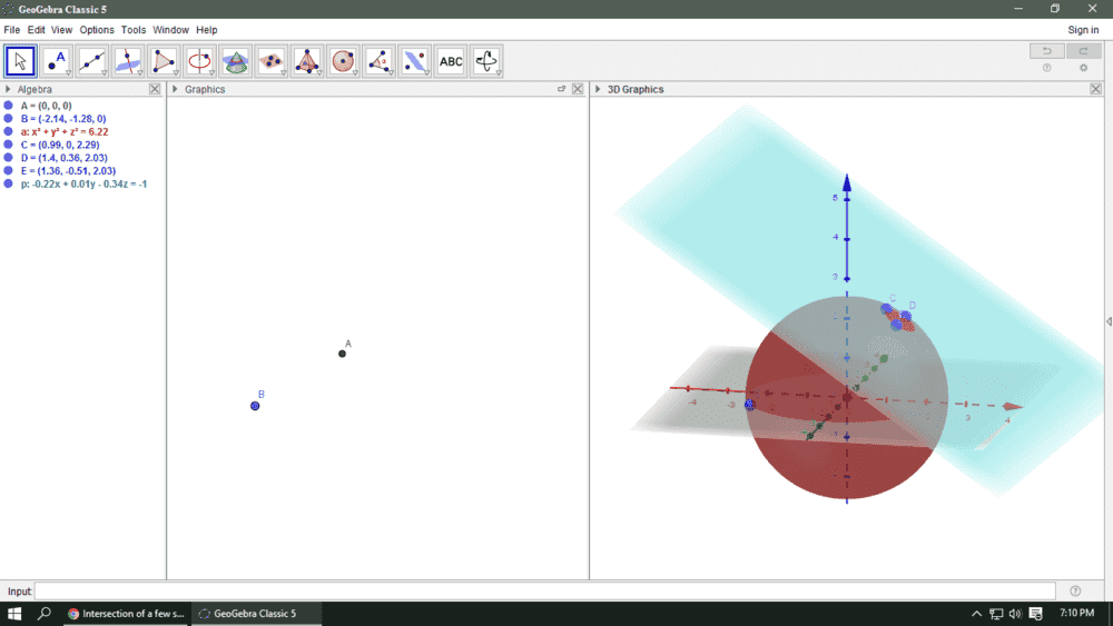

Summary:: Describe what the intersection of the following surfaces - one on one - would look like? Cone, sphere and plane.
My answers :
(1) A cone intersects a sphere forming a circle.
(2) A sphere intersects a plane forming a circle.
(3) A plane intersects a cone forming (a pair of?) straight lines.
Are these correct?
I wish we could have a 3-D tool to visualise.
Any suggestions?

Something on the computer will do. I am trying to understand how, for a point on the Earth's surface, the (unit) vector ##\hat e_r## points in a direction vertically upwards, ##\hat e_{\theta}## points along the south at that point and ##\hat e_{\phi}## points along the east. I have used a program to do something of the kind which I paste below.
I can get the directions of directions of ##\hat e_r## and ##\hat e_{\theta}##. It is ##\hat e_{\phi}## pointing to the east that am strugging with.

Perhaps you'll like Sketchup (Google) or SketchBook (AutoCad) ?
These are very specific planes and by no means generic: leave the equatorial plane, move the tangential plane inwards.
There are more (and far more interesting) options for these.

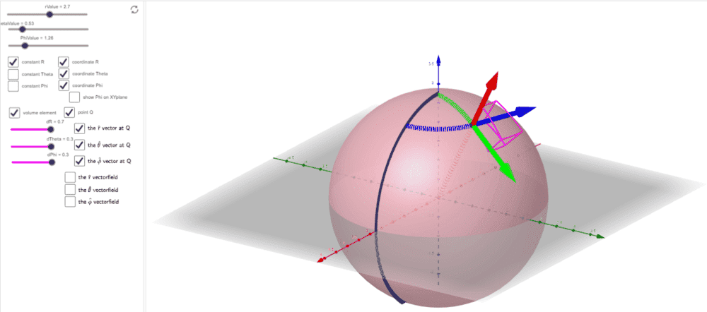

GeoGebra is great!
This visualization I made might help
https://www.geogebra.org/m/sjzxecxm
To get ##\hat e_{\phi}## , use the cross product of ##\hat e_r## and ##\hat e_{\theta}##.
Likes BvU
Thank you. I can "see" how ##\hat e_{\phi}## is directed to the "east" at the point in question. I was trying to imagine myself sitting at the center of the sphere and looking at the point and struggling.
