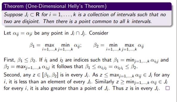

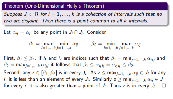

Here https://imgur.com/a/UlXhLRB there is a proof that I am trying to understand, before I do any kind of induction. My main question is, what exactly does the minmax and maxmin mean?
For each pair ##(i,j) ## an element ## \alpha_{ij}\in J_i\cap J_j## is chosen. They exist be assumption. Now you can imagine them written as a symmetric matrix ##A :=(\alpha_{ij})_{1\leq i,j\leq n}##. Then ##\beta_1## is the highest number of all column minima and ##\beta_2## the smallest number among all column maxima. So first consider each column and determine the smallest and the highest entry of each. Among those determine the highest number among the collection of the smallest, and the smallest among the collection of the highest entries per column. It's possibly easier to see with an example of there or four such intervals.

I see what you're saying when you write it out in words, but I don't see clearly how the notation works. What object exactly does ##\min a_{ij}## return? Is ##\max## acting on the ##\min a_{ij}## or is ##\max \min## taken as one object?
I just constructed a matrix as described, it doesn't say much of the actual intervals, only that e.g. ##7 \in J_2\cap J_3## or ##0 \in J_1\cap J_5\,.## The diagonal is the intersection of an interval with itself. The fact that this intersection is not empty is equivalent that none of the intervals is empty. In my case we have ##k \in J_k\,.##

That helps a lot, but I am still a bit confused. Later in the proof, it says, for example, that ##z \le \max_{j=1, \dots, k} \alpha_{ij} \in J_i##. I thought that ##\max_{j=1, \dots, k} \alpha_{ij}## produced a list of the maximum elements in each column, so how could it be a single number?
It says for any (each) ##i\, : \,\forall \,i \, (z \leq \max_{j=1, \dots, k} \alpha_{ij} \in J_i)## so the condition involves only one certain index ##i##, however, any ##i##.
