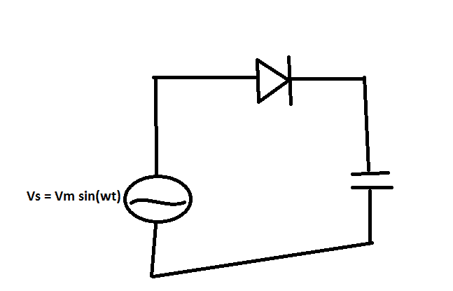

Into capacitor, half wave rectifier diode conducts for?
The diode in a capacitor circuit conducts for the first quarter-cycle (90 degrees) of the sinusoidal input voltage when the capacitor is initially uncharged. After this initial period, the diode does not conduct again unless there is a load in parallel with the capacitor that allows it to discharge. The discussion emphasizes the importance of integrating the current to find the expression for current flow. It also highlights that typical problems often focus on the conduction time after the initial quarter-cycle, rather than the entire cycle. Understanding these concepts is crucial for solving related circuit problems effectively.

The time for which the diode conducts is
Using integration and differentiation Vc = 1 / C integral (current)(dt)
Vs = -Vc
Vm sin(wt) = -Vc = - (1/C) integral (Idt)
now differentiate both sides to get expression for I that is current.
Vm (coswt) * w = -(1/C) I
So I = Vm(costwt) * C * w (-1)
So now i draw current wave, and then how to proceed? How do you get an answer for this? Am i to find out when current goes negative?

360 degrees was right for RL circuit but for RC answer is not given as the book is old and the page is torn.
i'm not sure what to do in case of given question of diode + C with charged as shown.
Expression is
So what to now?

For the circuit shown, if the capacitor is initially uncharged then the diode will conduct for the entire first ¼-cycle of sinusoid V.sin ωt. After that, the diode will never conduct again.
BUT your thread title says "RC" so shouldn't you have included a resistance in parallel to the capacitor?

Thanks, Quarter means 45 degrees right?

A full cycle is 360°, a half-cycle is 180°, so a quarter-cycle is ⬜❓
I don't like the question now. Are you sure it's how you want it? Almost no mathematics required.

Quarter cycle is 90 degrees. Darn i am so stupid.
We do need maths to find equation of current by integrating... Vc = 1/C (integration) (Idt)
This is current waveform. So it'll flow from 0 to 90 degrees.
Thanks.

Usually there is a load in parallel with the capacitor that causes it to discharge. This in turn causes the diode to conduct for part of each cycle (after the initial 1/4 cycle). In fact problems like this usually ignore the initial 1/4 cycle and only want you to calculate the time per cycle after that.
