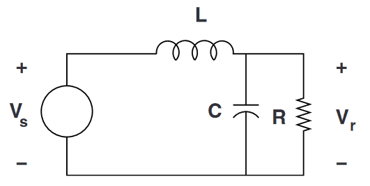

I am getting the wrong answer for Part B.
I don't understand if what I am doing for part C is correct.
Voltage divider rule
##V_{S} = 120V ##
##f = 60Hz##
##L = 20mH##
##R = 10\Omega ##
(a) Assume the capacitance is omitted. What is the resistor voltage?
##X_{L} = j\omega L = j2.4\pi##
##V_{R} = Vs\cdot \frac{R}{R+X_{L}} = 76.5067-j57.6847##
##V_{L} = Vs\cdot \frac{X_{L}}{R+X_{L}} = 43.493+j57.6847##
(b) What value of capacitance is required to make the resistor voltage have the same magnitude as the source voltage?
$$V_{R} = Vs\cdot \frac{R//X_{C}}{R//X_{C}+X_{L}}$$
$$R//C = \frac{R\cdot X_{C}}{R+X_{C}} = \frac{R\cdot \frac{1}{j\omega C}}{R+\frac{1}{j\omega C}} = \frac{R}{j\omega RC + 1}$$
$$V_{R} = Vs\cdot \frac{\frac{R}{j\omega RC + 1}}{\frac{R}{j\omega RC + 1}+j\omega L} = Vs\cdot \frac{R}{R+(j\omega L)(j\omega RC+1)}$$
$$V_{S} = V_{R} \equiv \frac{V_{R}}{V_{S}} = 1$$
$$1= \frac{R}{R+(j\omega L)(j\omega RC+1)}$$
$$(j\omega L)(j\omega RC+1) = 0$$
$$j\omega RC+1 = 0$$
$$C = \frac{-1}{j\omega R} = \frac{1}{120\pi\cdot 10} = 265.258\mu F$$
(c) What value of capacitance maximizes the resistor voltage? What is that maximum voltage?
$$V_{O} = V_{R} = Vs\cdot \frac{R}{R+(j\omega L)(j\omega RC+1)}$$
To increase the output voltage, I need to reduce the value of the denominator. I can do this by ##(j\omega RC+1) = 0## but this brings me back to the previous part of the question, which is incorrect for me.

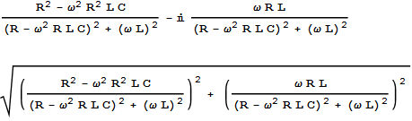

The first expression in this post shows a fraction embedded between absolute value bars. You must rationalize that fraction. Multiply out the two expressions in parentheses in the denominator, them multiply the numerator and denominator by the complex conjugate of the denominator. This gets rid of "j" in the denominator. Do it like this:
When this is done you can separate the new numerator into a real part and imaginary part so it will look like a+jb. The you can take the square root of the sum of the squares of both parts.
You'll get sqrt(a^2 + b^2) This will be the magnitude of the expression you started with and it won't contain any imaginary parts. You can set it equal to 1 and solve.

You didn't do the rationalization correctly; you don't have the correct complex conjugate. You have to multiply out the two expressions in parentheses in the denominator. Multiply out (j w L)(j w R C); then you can form the correct complex conjugate.
@The Electrician
Tried again:
\begin{align*}
\frac{R}{R-(j\omega ^{2}RLC + j\omega L)} \cdot \frac{R-\omega ^{2}RLC-j\omega L}{R-\omega ^{2}RLC-j\omega L} &= \frac{R^{2}-\omega ^{2}R^{2}LC - j\omega RL}{(R-\omega ^{2}RLC)^{2}+(\omega L)^{2}} \\ \\
&=\frac{R^{2}-\omega ^{2}R^{2}LC}{(R-\omega ^{2}RLC)^{2}+(\omega L)^{2}}-j\frac{\omega RL}{(R-\omega ^{2}RLC)^{2}+(\omega L)^{2}}
\end{align*}
I appreciate the help, but I don't think this is how the question is supposed to be solved. I think the original approach I took was more inline with what is expected.
But what you were doing originally didn't work. What I'm showing you will work.
Part of what you posted in the previous post got cut off. Here's what you should get. Now set the square root of sum of squares equal to 1 and solve. It's a lot of complicated algebra. Would you be allowed to find a numerical solution?
Edit: gneill has shown how to have a lot less algebra! :smile: :smile:
