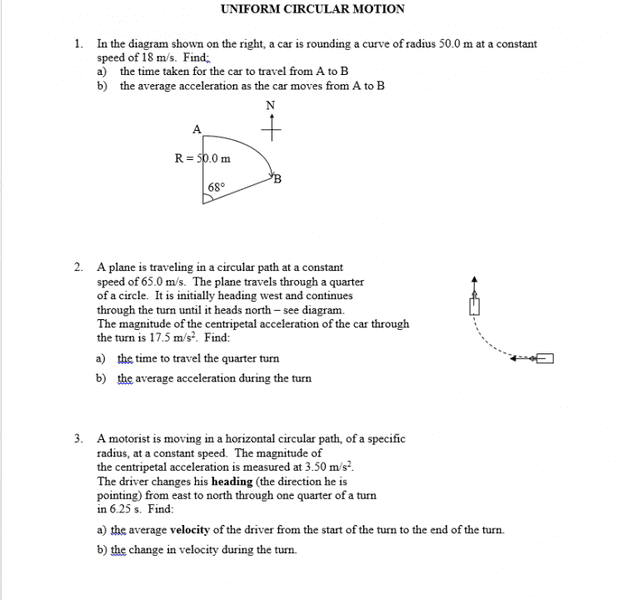

1. Homework Statement
1) centripetal acceleration = v^2 / R
2) centripetal acceleration = 4 pi^2 R / T^2
3) average velocity = displacement / time[/B]

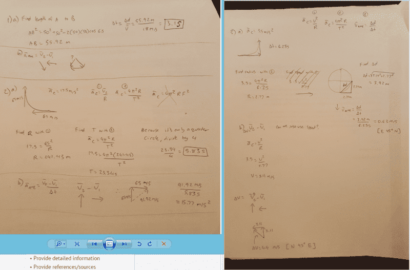

For #1a I first found the displacement of A to B. And then divided that by the speed to get time. However I feel like I am doing it wrong. Perhaps we need to find the centripetal acceleration first using equation 1 and then use equation 2 to find time. But then that would give the time of going around the entire circle. A bit torn on what do for 1a
For #1b I'm not sure where to put the angle. We just need to find the change in velocity and then divide it by the time we found in 1a. I just can't seem to pin point which angle I need to use and where I have to put it.
[/B]
For #2a I used equation 1 to find the radius. And then used equation 2 to find the time. Since we're only dealing with a quarter of a circle, I divided the time by 4. I believe I did #2a correctly
For #2b I found the the change of velocity and then divided it by the time we found in 2a. I don't think I found the change of velocity correctly
For #3a I first found the radius with equation 2. And then I found the displacement with pythagorean theory. Now that we have displacement, I divided it by the given time to get the average velocity
For #3bI got a little confused. To find the change in velocity, we need to do v2 - v1 however we don't know any velocities so I just went with speed which I believe is incorrect. I used equation 1 to find speed and then found the change in velocity using speed.
I attached my solution attemps below. Thank You !

Furthermore, if you don't tell what you've done and what you got, helping isn't made easy for us. E.g. in 1a): what was your reasoning, what did yuo calculate and what was the result ? What you wrote first looks quite reasonable, so why not tell us ? -- Unless you mean the handwritten stuff, but there you calculate the distance from A to B over a straight line, which can't be right indeed: the car follows the circular trajectory !

Also right above the pictures at the bottom, I have written down what I thought was correct for each question

For 1.a I believe I can find time once I get distance and speed. We have speed given however I am not sure how to find the distance.
Can we do the following?:
We know that distance is 2πR so therefore we can find the time of the entire circle. We know the entire circle is 360 degrees however we just want 68 degrees of the circle. Therefore could we just do 360 divided by 68? And then divide the total time by that value?
It holds some logic to me but I am not sure if that's the correct way of doing it.
Length of an arc of 68##^\circ## on a circle with radius 50 m should not pose a problem ! If the whole circle is ##2\pi R## that ##2\pi## is the angle. If the angle is ##\alpha## the arc is ##\alpha R## ! (with ##\alpha## in radians !)
for b) you want to use the definition of average acceleration: ##\ \vec a_{\rm \,avg} \equiv {\Delta \vec v \over \Delta t}\ ##.
Delta v is the change in v, so ##\vec v_2 - \vec v_1##. It has a magnitude and a direction.
Ah I never thought about doing that.
I did: 68° × π/180 × 50 = 59.34m
59.34/18 = 3.3 s for the time
However for 1b I am still unsure on what to do. We need velocity but we only have speed
Speed is the same, only: the direction has changed !
In your left drawing I see on the left ##v_2## and on the right ##-v_1##. Now add them up, as you do in your right drawing. For the ? you know two magnitudes (18 m/s) and one angle (68##^\circ##). Bob's your uncle !
