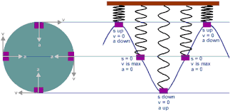

You can show an animation of SHM as a projection of Uniform Circular Motion. I think high school students are familiar with UCM.
There are plenty of images and videos available on google and youtube. This is one of them.
Likes Mayan Fung
