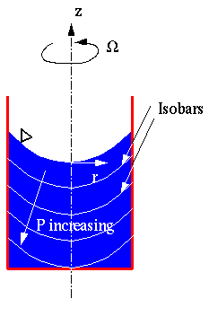

In summary: Pressure decreases as you go higher up in the container, which is consistent with the idea that the liquid is being pulled up the walls by centrifugal force.

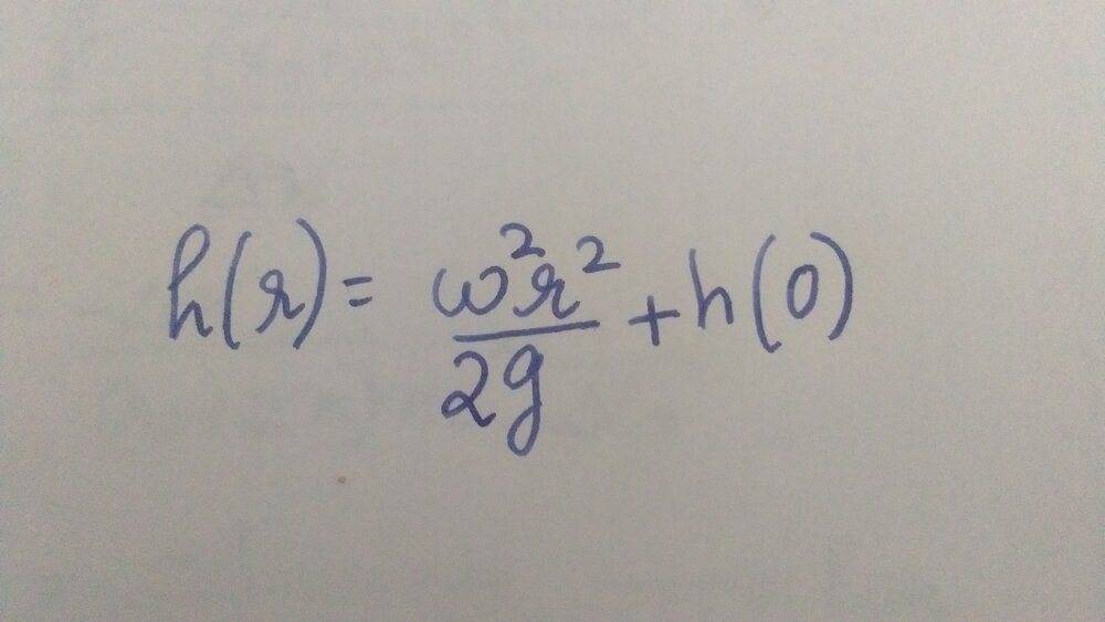

h(r) = ((wr)^2/2g) + h(0)

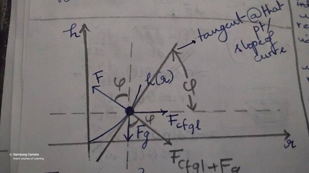

I have understood the derivation of the parabolic shape by equating the normal force, gravity and the centrifugal force. But this derivation begins with the fact that water is at equilibrium.
I want an understanding (quantitative or qualitative) of why the water which was flat in the beginning climb up the walls of the container. What force causes it to?

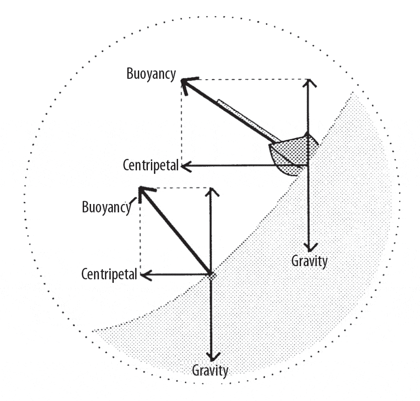

Yes, but each small volume of liquid must be in equilibrium of forces, otherwise it would move or flow in some direction.
Centripetal acceleration of any mass depends on the tangential velocity, which depends on its radius of rotation.
Just like you must lean your bicycle in a curve, that small volume closer to the walls of the container must "lean" more respect to the small volumes located closer to the center, which have a smaller tangential velocity.
Please, see:
https://www.me.psu.edu/cimbala/Learning/Fluid/Rigid_body/rigid_body.htm
Slowly but surely, the rotational energy of the bucket is transferred into the liquid.
Because the pressure inside the liquid depends on its vertical height, you could measure a higher pressure next to the walls than by the center of rotation.
That is the principle behind the centrifugal pumps.

View attachment 281161View attachment 281162
Lnewqban, so the dV volume near the container must experience less centripetal force(more centrifugal force) than the dV near the axis of rotation
Similarly the dV in the outer edge must lean more so that the normal force can balance the centrifugal + Gravity.
Thus, we have a paraboloid.
More pressure near the walls is due to the weight of the volume of water above. I do not know the navier stokes equation, so I will check that article after I learn it (as soon as possible)
Am I right?
Please correct me if I am wrong.

At any point on the surface, you have a vertical force tending to produce an acceleration g and a horizontal centrifugal force tending to produce an acceleration rω2. These add to produce a tilted force. This must be normal to the local surface (or water would flow up or down the gradient).
This allows you to write a differential equation, and the solution is a parabola.

By vertical force, do you mean the force due to the nearby water molecules. I have derived the parabola's equation.
But the derivation starts from a molecule which is already at equilibrium in the parabola. I consider this experiment to be happening on earth.
I wanted to know how (the process) does the water change its shape from flat to a parabola. By Halc's and Lnewqban's answer I have come to know that it is due the centrifugal force (due to inertia) that water changes shape to a parabola. Since water has nowhere else to go than up, it rises up under the influence of centrifugal force till the normal force can balance the centrifugal force.
No, I mean gravity. The nearby molecules produce the normal force.
Good.
If you increase the rate of rotation then the centrifugal force increases and the net force (centrifugal +gravity) is no longer normal to the surface. It will have a component that points radially outward relative to the normal, pushing molecules up the slope.
This is no different than mentioned by other posts above. The point of my post #11 was how to derive the equation.
