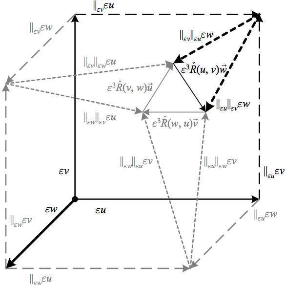

It is actually not too difficult to directly get to the commutator definition of the Riemann tensor from the idea of parallel transport. For infinitesimal parallel transport from a point ##p## along a curve ##\varepsilon v## with tangent ##v##, the covariant derivative is defined as
$$\nabla_{v}w\equiv\underset{\varepsilon\rightarrow0}{\textrm{lim}}\frac{1}{\varepsilon}\left(w\left|_{p+\varepsilon v}\right.-\parallel_{\varepsilon v}\left(w\left|_{p}\right.\right)\right),$$
so dropping the limit,
$$\parallel_{\varepsilon v}(w\left|_{p}\right.)=w\left|_{p+\varepsilon v}\right.-\varepsilon\nabla_{v}w\left|_{p}\right..$$
Applying twice, we have
$$\begin{aligned}\parallel_{\varepsilon u}\parallel_{\varepsilon v}(w\left|_{p}\right.) & =\parallel_{\varepsilon u}\left(w\left|_{p+\varepsilon v}\right.-\varepsilon\nabla_{v}w\left|_{p}\right.\right)\\ & =w\left|_{p+\varepsilon v+\varepsilon u}\right.-\varepsilon\nabla_{v}w\left|_{p+\varepsilon u}-\varepsilon\nabla_{u}w\left|_{p+\varepsilon v}\right.+\varepsilon^{2}\nabla_{u}\nabla_{v}w\left|_{p},\right.\right., \end{aligned} $$
so that
$$\begin{aligned}\parallel_{\varepsilon u}\parallel_{\varepsilon v}(w\left|_{p}\right.)-\parallel_{\varepsilon v}\parallel_{\varepsilon u}(w\left|_{p}\right.) & =\varepsilon^{2}\nabla_{u}\nabla_{v}w\left|_{p}\right.-\varepsilon^{2}\nabla_{v}\nabla_{u}w\left|_{p}\right.\\ & =\varepsilon^{2}\check{R}(u,v)\vec{w}. \end{aligned} $$
Here we have assumed ##[u,v]=0##, so that ##w\left|_{p+\varepsilon v+\varepsilon u}\right.=w\left|_{p+\varepsilon u+\varepsilon v}\right.##. This actually doesn’t constrict the result, since the curvature being a tensor means that ##\check{R}(u,v)\vec{w}## only depends upon the local values of ##u## and ##v##, so we are free to construct their vector field values such that ##[u,v]=0##.
This approach, detailed here, can be used to build a geometric picture of the first Bianchi identity:
One can also start from the definition in terms of the exterior covariant derivative ##\check{R}\left(u,v\right)\vec{w}=\left(\mathrm{D}^{2}\vec{w}\right)(u,v)## to arrive at another picture in terms of parallel transport:
More details here.
