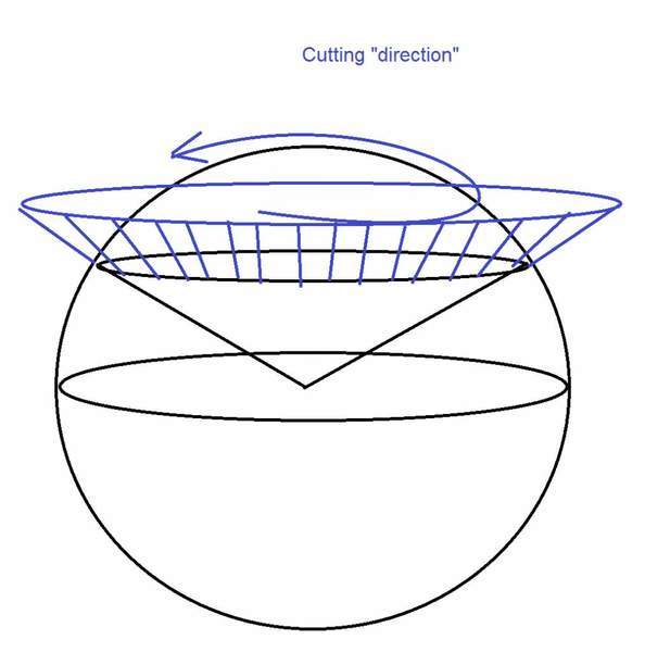

Let me chime in with what I mean by the "greedy" algorithm. I do believe it's the same concept as proposed here:

What happens when you cut a sphere with a knife along the 45 deg N parallel circle? I bet I can make the knife contain the normal in each point to the sphere, and still be able to cut the sphere along that exact curve. And that's no geodesic.

I haven't tried it literally (I suppose a knife and an orange would do..), but I did manage to splash some odd looking depiction of what I'm imaging in a png file. I am cutting along the 45N parallel. My task is: make sure my knife contains the surface normal and that I do not cut something else apart from the curve. I guess that's not impossible, and here's why: imagine a cone with the vertex at the center of the sphere, containing the parallel circle. Cutting that circle means keeping the knife tangent to the cone's surface, fixing the knife's tip at the center of the sphere. That seems to be possible. What am I doing wrong?
Now, see the "blue" band the normal vectors then describe? That band is a cone frustum/ cone section. If that were to a great circle, then that band would've been a simple difference of two discs. My moral is: I can cut the surface and keep the knife along the normal field, and that would not forbid me to "turn" the knife while staying along the path. In that case, the knife is guided by the surface of the cone. The knife constraint, therefore, needs to be restated. I'd say, if correct!, that this "knife mechanism" must produce a "band" (or trail ribbon, as CG guys call it), that can be pulled through some sort of slit without "pushing" on the walls of that slit. In other words, that ribbon surface must be pulled through a a rectangular opening ( || <- the slit ) just like the one from an ATM credit card machine without having the ribbon ripped, teared or damaged in any way from this process. I tend to think that the cone bit an cutting the parallel works because I drag my knife along the surface and exert pressure (other than advancing pressure), while trying to keep on the trajectory.
This concept of a ribbon also appears here -> http://en.wikipedia.org/wiki/Torsion_tensor (in the wikipedia picture of a torsion along the geodesic). Is it in any way connected to the manner in which one "cuts a surface with a knife"?

The blue vectors are not tangent to the sphere, they are normal. I'm not sure if what you're trying to do is do parallel transport along the sphere, but you have your cone upside down for that. The parallel transport on a sphere is the same as parallel transport along the lip of a tangent cone "hat" so to speak (flip the cone upside down). The difference in parallel transported vector's angle from the original vector is the same as the deficit angle for the cone.
Yes, I was trying to answer to lavinia's suggestion of actually cutting a manifold (e.g. sphere) with a knife that contains the normal vector and this way describing a geodesic. I exemplified by cutting along the 45 deg N lat circle. What I did was to squeeze a cone that contained this circle and had its vertex in the center of the sphere. If you take small Δl elements of that circle and join them with the cone's vertex, you can get lavinia's knife sticking deep inside the sphere. If you move along the circle, you can cut the sphere and see the knife always "containing" the normal.
I understood what you said: the cone's tangent planes coincide with the sphere's tangent planes, and hence the parallel transported vectors lie on a cone. If developed in a plane, the vectors shift in orientation by exactly the angle deficit, as you specified. Although very important as an example, this cannot be generalized, whereas Lavinia's "method" of "knifing" the manifold should work regardless of the surface (we cannot fit a developable surface to contain those vectors for any kind of surface, unfortunately, otherwise I'd have been satisfied with putting "cone hats" on manifolds and detect how much off a curve is from being a true geodesic).

If you are trying to draw geodesics, that circle you drew out is certainly not a geodesic. Geodesics on a sphere are great circles.

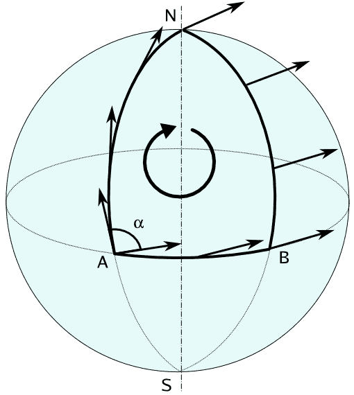

Any closed loop on a surface is just an n-polygon with n -> infinity just like on the Euclidean plane. So think of a latitude circle on the sphere as a regular n-polygon. The simplest polygon is a triangle in the most extreme case. So on the sphere, let us degenerate a latitude circle to a spherical triangle...
This triangle has two vertices on the equator say, and one on the north pole. Now start with a vector on the equator parallel to a side of this triangle, a longitudinal line that is, and move your vector up this line ( it does not change its angle with it until it reaches the north pole, identically zero that is! ). But it forms an angle with the other longitudinal line when it reaches the north pole. So when you parallel transport this vector down to the equator again along the other side, and back on the equator to where you started it points to a different direction. The turn in radians of the vector is exactly the angle of the triangle at the north pole and this is parallel transport.

When you parallel transport a vector along any infinitesimal polygon line on that surface, it is by a geodesic line that you approximate that line on that surface, you cannot differentiate otherwise! Then you project your vector to the plane where the next infinitesimal line lies and so on and so forth...

Along a geodesic on a surface, parallel transport just means sliding the vector along the curve keeping its length and angle to the tangent constant. It does not mean this on an arbitrary curve. Also if the intuitive idea is going to help us imagine higher dimensional examples - e.g. space-time - it should not, in my opinion, depend completely on 2 dimensional geometry but should indicate a general principle.

And the basic idea is that parallel transport of a vector along a geodesic line, leaves the angle between the vector and the tangent to this line unchanged! Am I wrong? Please correct me!
It is by passing from one geodesic line to another that this angle changes!
Do not be confused by the triangle. It is just an extreme case to elucidate this point.
