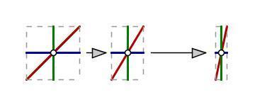

There are various explanations for Thomas precession in the literature and I would like to come to a deeper understanding of the cause for this precession, so that maybe I can understand better whether Thomas rotation is applicable to the precession of a gyroscope orbiting around a gravitational body.
This paper gives an explanation in terms of an aircraft following a circular path. The argument is that if the circle is approximated by a polygon, then the angle for each corner of the polygon as measured by an observer on the aircraft is larger than the angle measured by an observer at rest with the polygon. One problem with this explanation is that it implies the rate of precession of the rod is constant (for constant angular velocity of the aircraft). This is not necessarily the case (See below). Another question is why should a gyroscope behave as if it is measuring angles of a path that is at rest in another reference frame?
The paper then converts the equation for the Thomas precession into a form that suggests that the precession is a result of centrifugal force. The problem with this interpretation is that an gyroscope in a perfect geodesic orbit around a gravitational body, experiences no proper forces, so no Thomas precession should occur. Then again, some authors would argue that Thomas precession does not occur in the gravitational orbit and this interpretation would support that view. To quote Wikipedia:
One can attempt to break down the de Sitter precession into a kinematic effect called Thomas precession combined with a geometric effect caused by gravitationally curved spacetime. At least one author[6] does describe it this way, but others state that "The Thomas precession comes into play for a gyroscope on the surface of the Earth ..., but not for a gyroscope in a freely moving satellite."[7] An objection to the former interpretation is that the Thomas precession required has the wrong sign.

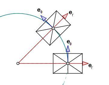

Another point of view is that Thomas precession is simply the result of the rotation that occurs when two consecutive non parallel Lorentz boosts are carried out. This is the interpretation outlined in this mathpages article. A consequence of this interpretation is that the precession rate for a given gyroscope is not constant for a constant velocity orbit. The diagram below illustrates this effect.
In the diagram two orthogonal gyroscopes (initially represented by the blue and red vectors) start at the 3 O'clock position and progress around the circle in an anticlockwise fashion. It can be seen that from the point of view of an inertial observer at rest with the centre of the circle, that the blue and red gyroscopes do not remain at right angles with respect to each other and do not precess by the same amount per complete 'orbit' unless by chance the angular velocity has certain critical values. The equation normally given for Thomas precession is just an average figure for many orbits. (Mathpages explains this in quite a lot of detail).
Finally page 235 of this paper by Malament gives a intuitive description of the precession of gyroscope being the result of the gyroscope following a path that deviates from the path of a photon that initially travels in the same direction. This has the nice quality that it applies in both Special and General relativity.
Which, if any, of the above explanations best describe what is really happening in Thomas precession?
P.S. Is aberration a factor? If an observer traveling in a circle points a telescope at a distant star and compares the direction the telescope is pointing relative to a gyroscope, will the angle of the telescope oscillate due to the periodically changing aberration factor, according to an inertial observer at the centre of the circle?

yuiop said:
...gives a intuitive description of the precession of gyroscope being the result of the gyroscope following a path that deviates from the path of a photon that initially travels in the same direction.
By the way, you have to be careful in your interpretation of that intuitive description because it is meant to relate directly to the contents of proposition 3.2.5. which says that in a static space-time (such as Schwarzschild space-time), an axisymmetric rigid ring is non-rotating in the sense that ##\eta_{[a}\nabla_b \eta_{c]} =0## for all possible angular velocities if and only if light can circulate the ring whilst freely falling. If you recall that ##\eta_{[a}\nabla_b \eta_{c]} =0\Leftrightarrow F_{\hat{\eta}}(h^{a}{}{}_{b}\phi^b) = h^{a}{}{}_{b}\hat{\eta}^c \nabla_c (h^b{}{}_{d}\phi^{d}) = 0## then this proposition basically states that in static space-times a gyroscope fixed to the ring with its spin axis initially aligned in the direction of ##\phi^a## remains aligned in the direction of ##\phi^a## if light can circulate the ring in free fall for all possible angular velocities of the ring. So this proposition isn't telling you why gyroscopic precession does or does not occur, it simply tells you how to detect it in very specialized systems.
:eek: This is certainly false! All I can figure is that this is an artifact of replacing Thomas precession, which is a continuous process, by a discrete set of Lorentz transformations.

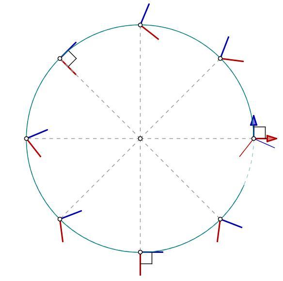

In the diagram the rectangles represent consecutive positions of an orbiting lab. It is perfectly square in its own rest frame but appears rectangular due to length contraction as a result of its orbital motion. The lab is anchored to the centre of the orbit such that ##e'_{r}## always points directly away from the centre of orbit and ##e_{\phi}## is always tangential to the orbital path. If the local ##e_{/phi}## and ##e_{r}## principle axes of the lab were made of steel and welded to each other such that they remain perpendicular to each other, would these axes represent the orthonormal rest frame of a locally non rotating observer, iff the orbital velocity of the lab is that of a ZAMO? If so, (staying with the assumption of ZAMO velocity) would gyroscopes in the lab precess relative to these axes or not? Would their behaviour relative to the non principle diagonal axes be any different? If the lab frame as I have presented it does not represent the orthonormal rest frame of a non rotating observer, what should such a frame be called and what is a orthonormal locally non rotating frame at rest with? Is the lab frame stationary with respect to Lie Transported Basis vectors or do those vectors always point at a stationary point at infinity? Finally, for completeness, of the lab was rotating at some velocity such that un-torqued gyroscopes are precessing in the lab, could two such gyroscopes that are orthogonal to each other represent Fermi Walker basis vectors? In other words, are un-torqued gyroscopes always at rest with FW basis vectors that are transported along with the gyroscopes, by definition?
The non principle diagonal axes demonstrate how the precession rate can be constant in one reference frame and not in another. In the rest frame of the lab, the diagonal axes are at 45 degrees. If there is a precessing gyroscope that rotates from ##e_{r}## to ##e_{\phi}## in 20 seconds in the lab rest frame, then it passes the intermediate diagonal axis in half that time (10 seconds) assuming constant precession in the lab. To an observer at the centre of the orbit, the gyroscope takes longer to get to the 45 degree position from ##e'_{r}## than it takes to get from the 45 degree position to ##e'_{\phi}## so the rotation is not constant but oscillates, getting faster as the gyroscope gets near the tangential position and slowing down again as it gets orthogonal to the tangential position. This pretty much agrees with drawing in the OP. The oscillating precession comes about as a result of the length contraction distortion of the lab fame in the external frame, so the two frames disagree on the position of the 45 degree axis relative to the principle orthogonal axes of the lab.
Another interesting observation (which I might of mentioned in a previous thread) is that the time dilation of a clock carried by a ZAMO relative to infinity is identical to the time dilation of a static observer relative to infinity in the Kerr metric. This seems quite surprising so maybe I have miscalculated. (They are both equal to ##\sqrt{1-2m/r}##). A clock with any other orbital velocity does not have this property.

yuiop said:
Peter gave the precession rate as being equal to the orbital velocity ##-g_{t\phi}/g_{\phi\phi}##.
To be clear, this is the precession rate of a gyroscope carried by a ZAMO, relative to a static observer at infinity. This means that an observer at infinity will see a gyroscope carried by the ZAMO precessing (rotating) with the same angular velocity as the ZAMO revolves around the hole. So, for example, a gyroscope that starts out pointing directly radially outward from the ZAMO will always point directly radially outward from the ZAMO; relative to the static observer at infinity, the direction the gyro is pointing will rotate because the ZAMO is revolving around the hole.
As WBN pointed out, the ZAMO congruence has nonzero shear, so a gyroscope carried by a ZAMO that points directly radially outward will *not* remain pointing directly at the same neighboring member of the ZAMO congruence. A ZAMO slightly further outward, radially, will "fall behind" the direction in which the first ZAMO's gyroscope is pointing.
yuiop said:
It does not really make sense to use concentric ZAMO rings (with different r and different angular velocity) as a reference frame.
Right, because the ZAMO congruence is not rigid.
Yes.
No, they wouldn't.
No; if the gyro isn't precessing relative to the principle axes, it isn't precessing relative to any axes.

Take the much simpler example of an observer ##O## in flat space-time with 4-velocity ##e_0 = (1,0,0,0)## relative to a global inertial frame. Now superimpose on ##O## another observer ##O'## who is identical to ##O## in the sense that they both have the same world line ##\gamma## and 4-velocity ##e_0##. Let's attach to ##O## the spatial axes ##e_{1} = (0,1,0,0), e_{2} = (0,0,1,0),e_{3} = (0,0,0,1)## and attach to ##O'## the spatial axes ##e'_{1} = (0,\cos\omega t,0,0), e'_{2} = (0,0,\sin \omega t,0),e'_{3} = (0,0,0,1)##. Then ##O## is non-rotating because the ##e_{i}## are Fermi-transported along ##\gamma## i.e. gyroscopes at rest in ##O##'s frame do not precess. However ##O'## is certainly rotating because the ##e'_{i}## are not Fermi-transported along ##\gamma## hence gyroscopes at rest in this frame will precess: ##F_{u}e'_{i} = \frac{\mathrm{d} e'_{i}}{\mathrm{d} t} \neq 0, i\in \{1,2\}##. But the only difference between ##O## and ##O'## is the choice of frame (spatial axes) we've attached to each. In other words, both ##O## and ##O'## follow orbits of the vector field ##\nabla^{\mu}t## but only one of them has a frame in which gyroscopes don't precess.
So does it make sense to interpret the statement "zero angular momentum observers are non-rotating" as "gyroscopes at rest in the frame of a zero angular momentum observer don't precess"? I don't think so, particularly for the reasons explained above. There is no "the" frame of a given zero angular momentum observer, indeed for any observer in GR. We can find a frame for a given observer in which gyroscopes don't precess but we can just as easily find another frame for the same observer in which gyroscopes do precess, such as the one provided by MTW.
So how should we interpret the statement "zero angular momentum observers are non-rotating"? Here's how MTW does it (I'm paraphrasing but I'll include an attachment as well). Consider a given such observer from the family; this observer follows an orbit of the vector field ##\nabla^{\mu}t##. As the name suggests, ##L = \phi_{\mu}\nabla^{\mu}t = 0## where ##\phi^{\mu}## is the axial killing field. Hence if we imagine this observer as riding on a ring that has mirrors of the appropriate geometry places along it so that light beams emitted by the observer can circulate the ring then two such light beams emitted in clockwise and counterclockwise directions around the ring will arrive back at the observer simultaneously according to his local time. Recall from Malament's paper that this is exactly his zero angular momentum measure of non-rotation (we can apply the relevant theorem from the paper to the family of zero angular momentum observers because there are no space-time derivatives involved-that problem only arises for the compass of inertia on the ring measure of non-rotation).

I was just considering the implications of proper acceleration on the centre of mass of a gyroscope in any spacetime, but yes, in curved spacetime, it would be necessary to think in terms of momentarily comoving inertial frames. In the particular case of flat time, consider the following diagram:
The gyroscopes represented by the green, red and blue lines are accelerated from left to right. It can be seen that the red diagonal gyroscope precesses relative to the original reference frame in a single boost. An observer co-accelerating linearly with the gyroscopes (so he experiences proper acceleration) does not notice any precession of the gyroscopes in his rest frame and does not feel any torque. To this accelerating observer, it is the gyroscopes in the original rest frame that are precessing. Anyway, since the observer experiencing proper acceleration does not see any precession in his rest frame, then by the equivalence principle, a static observer in the Schwarzschild metric does not see a local gyroscope precessing (contrary to my earlier musings).
However, the rotation described here is as real as the Thomas rotation due to two consecutive boosts. They are both effectively the result of distortion due to differential length transformation. A clock transported in a path that returns to its original location has less elapsed time than a clock that remained at the stating location, while a rod that follows the same path, is still the same length as a comparison rod left at the start. This often makes people think that length contraction is somehow less 'real' than time dilation. However, if Thomas rotation is thought of as a cumulative effect of differential length contraction, then the change in orientation of a rod transported without any torque, relative to its original position at the start can be thought of as a tangible lasting effect of length contraction.

WannabeNewton said:
On the other hand the unit vector ##e_{r}## is not locked to ##O'## (or any observer for that matter) i.e. ##\mathcal{L}_{\xi}e_r \neq 0## so the gyroscope colinear with ##\lambda^{\mu}## will precess relative to ##e_r##. Can you picture that?
Yes, I can :wink:
If we pick a infinitesimally close neighbouring ZAMO on the same ring then the Lie transported vector pointing at this neighbour, will be stationary with respect to the ##e_{\phi}##, because these two ZAMOs are Born rigid. This suggests that gyroscopes do precess relative to ##e_{r} ## as you describe, but do not precess relative to ##e_{\phi}##. Is that correct, or can Lie transported vectors only be defined in terms of neighbouring ZAMOs that are NOT on the same ring?
  • #31
yuiop said:
By this description, two orthogonal gyroscopes, cannot remain orthogonal to each other, even according to an observer in the rest frame of the gyroscopes, in Kerr spacetime. I am not entirely comfortable with that.
Check out Peter's post #21 where he describes in some detail the issue you bring up. By definition, the gyroscopes must remain orthogonal to one another because they are Fermi-transported along the chosen world line and Fermi-transport preserves orthogonality. On the other hand, if a gyroscope doesn't precess relative to a connecting vector locked between two ZAMOs on neighboring orbits then, unless I'm missing something obvious, the gyroscopes can't remain orthogonal because this connecting vector is dragged along by the difference in angular velocities of the ZAMOs whereas the connecting vector between two neighboring ZAMOs on the same orbit sits idly by (for the reasons you mention below), as explained by Peter in post #21. But a relatively large number of GR texts as well as papers (see references in the above posts) state that vanishing vorticity implies connecting vectors locked onto all neighboring observers (so in our case those in the same orbit as well as those in different orbits) don't precess relative to local gyroscopes. This is why Peter and I were thrown aback and this is why, in retrospect, you should be much more circumspect of my statement in post #18:
While Lie transported vectors can certainly be locked onto neighboring ZAMOs on the same ring...
yuiop said:
This suggests that gyroscopes do precess relative to ##e_r## as you describe, but do not precess relative to ##e_{\phi}##.
I'm a bit hesitant in affirming this only because, and I may just be falling into the trap of using my intuition here, is it possible for a gyroscope to precess relative to ##e_r## but not relative to ##e_{\phi}##? If it rotates relative to ##e_{r}## then doesn't it also have to rotate relative to ##e_{\phi}##?
