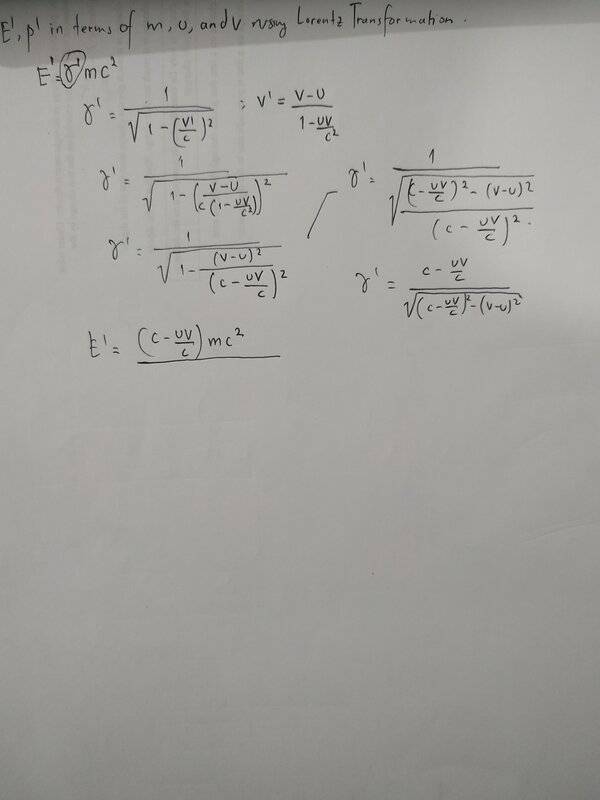

Suppose an observer O measures a particle of mass m moving in the x direction to have speed v, energy E, and momentum p. Observer O', moving at speed u in the x direction; measures v', E', and p' for the same object. (a) Use the Lorentz velocity transformation to find E' and p' in terms of m, u, and v. (b) Reduce (E')^2 - (p'c)^2 to its simplest form.
Lorentz velocity transformation:
$$v'=(v-u)/(1-(uv/c^2))$$
Relationship between energy-momentum:
$$E^2=(pc)^2 +(mc^2)^2$$
I try to use relativistic energy equation:
$$E'=\gamma mc^2$$
But, I use
$$\gamma=\frac{1}{\sqrt{(1-(\frac{v'}{c})^2}}$$
then I use Lorentz velocity transformation.
$$v'=\frac{v-u}{1-\frac{uv}{c^2}}$$
At the end, I end up with messy equation for E' but still have light speed c in the terms. How should I do to get E' just in terms of m, u, and v?
It's hard to help without seeing what you've done. Part a) is going to get messy doing it the way the question asks.
This is my work
What I would do is use the Energy-Momentum transformation to calculate ##E', p'## the sensible way. Then, at least you know what you are aiming for.
Energy momentum Transformation is:
$$E^2 = (PC)^2 + (m c^2)^2$$?
Or what equation do you refer to?
Is my early step is right?

The Lorentz Transformation applies to all four-vectors, including the energy-momentum four vector. If you haven't seen that yet, then don't worry.
The problem you have is that it's not easy to see how to simplify what you have unless you know what expression you are aiming for.
Hint: try to find factors of ##\gamma_u## and ##\gamma_v## in what you have.

Well, I tried to solve the problem again and got this:
$$E'=\gamma_{v} \gamma_{u}(1-\frac{v}{c} \frac{u}{c}) (mc^2)$$
$$p'=\gamma_{v} \gamma_{u}m(v-u)$$
Then, I got
$${E'}^2 - {p'c}^2={mc^2}^2$$
Is it right?

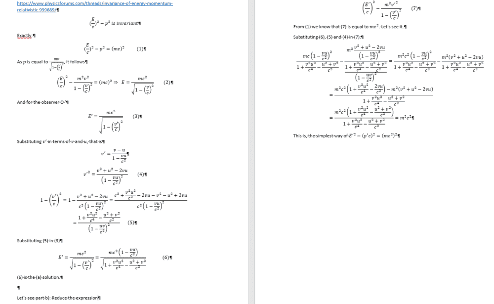

Here is the pdf file.
In the image, where it says "we know that (7) is equal to mc^2" it should say "we know that (7) is equal to (mc)^2".
  • Invariance of Energy Momentum GNavas.pdf
What about? $$\frac{1}{\gamma'^2} = 1 - (v'/c)^2 = 1- \frac{v^2 + u^2 -2uv}{c^2(1- \frac{uv}{c^2})^2} = \frac{c^2(1 - \frac{v^2}{c^2} - \frac{u^2}{c^2} + \frac{u^2v^2}{c^4})}{c^2(1- \frac{uv}{c^2})^2} = \frac{(1- \frac{v^2}{c^2})(1 - \frac{u^2}{c^2})}{(1- \frac{uv}{c^2})^2}$$ Hence:
$$\gamma' = \gamma_u \gamma_v (1- \frac{uv}{c^2})$$
