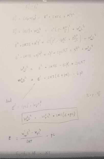

iii) Compute the numerical values of δE and E in eV. [2 marks] iv) How would your expression for the proton energy change if the photon and proton collided at right angles?I got all the way to b) ii but I could not get to the given expression for E.
Can anyone point give me any clues? I am pretty sure it's just algebraic work that I can seem to simplify.
I manage to get to this:
$$ E= \frac {m_∆^2 c^4−m_p^2 c^4} {2k_BT_{CMB}} - cp $$
This seems close but I can't get rid of the cp (also note that mine is divided by 2 not 4 as expected).
Thanks a lot.

Show your work please.
Hope it is clear enough.
Thanks a lot.
You're missing the same trick I showed you yesterday. You have:
$$E + pc = X \ \ (1)$$where$$X = \frac {m_∆^2 c^4−m_p^2 c^4} {2k_BT_{CMB}}$$Now$$m_p^2c^4 = E^2 - p^2c^2 = (E-pc)(E+pc) = (E-pc)X$$$$\Rightarrow \ E - pc = \frac{m_p^2c^4}{X} \ \ (2)$$Now, add equations (1) and (2).
Wow! This is unbelievable. I was blind and now I see. :)
I guess a need to do 100 more of these.
Thanks a lot!
