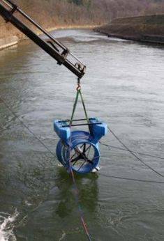

Hello. My name is Robert, I am 30 and i have been an inventor for 10 years.
I have been developing ideas to the thinnest details. Unfortunately, my life was a little hard and i don't have a mechanical/physical/electrical/ background. But i get a lot work done without that. I design 3D's of some of my projects, even tried some animations, but keep getting stuck with free versions of programs... I want to talk with some experts in diy field, i want to start my projects and make some prototypes, i even plan on buying a 3D printer.
Up in the picture is my first project for presentation, a water turbine for river bottoms with a water flow blocker, or it can be used as a VAWT, in the picture bellow,
with a blocker that moves (rotates on a bearing using wind fin)
Air, water, who cares, as long as it gives green power.
The blocker is used to stop the water/air forcing the turbine in the wrong direction.
Ok, so This is enough for today, i have a lot of amasing stuff, and this is just one design, i would really like some comments, so, please, comment. Thanks for reading.
Edit: Just realized that the system with the fin can be used on river bottoms with changing flow directions..

Welcome to the PF, Robert. :smile:
So far I'm not understanding the use of the "blocker" part. It seems like it will always be in the way, preventing the paddlewheels from being turned by flowing water. Can you show a sketch of one in a river with flowing water to clarify that?
Also, are you familiar with the difference in efficiency between a paddlewheel design and a propeller design? Why is the propeller design for wind/water generators usually so much more efficient? :smile:

Blocker is used because only 1/4 of this type of turbine is active. The other 1/4 is proactive, it blocks the spinning because it rotates in the different direction.

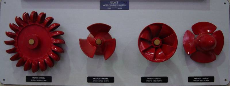

There are many designs of water turbines, each optimum within a specific range of pressure difference and flow rate.
Water wheels are one, kaplan turbines, frances turbines, propeller turbines, Tyson turbine, pelton wheels.helical turbines, cross flow turbines, screw turbines, Jonval turbine, Turgo turbine. That list is not complete. Wikipedia has descriptions and pictures of most of them.
To get people to be interested in your design, you'll have to be able to answer questions. How much pressure? How much flow? What RPM? What is the best case efficiency? You'll need a textbook and some study to be able to do that.

So this is a windmill.
White arrow is turning it. Orange arrows are the way it rotates. The blue arrow is hitting the blocker because if it would hit the paddle wheel it would push it in the opposite direction that it should go.

I am afraid this is self contradictory.
You can't improve a design without understanding why it works (or doesn't work) nor without understanding how to compare different designs in terms of efficiency - which requires math. And physics. Otherwise you will be mostly wasting time :frown:
Please remember there is already tons of knowledge, people have spent millions of hours optimizing turbine designs using sophisticated math models. Just logic is not enough to beat them.
