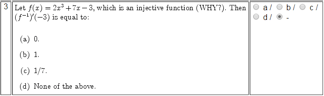

How do I solve this. Getting an inverse alone seems to be a quite long route. Is there an easier way of doing this?
edit: Please read and respond to post #3 first (it provides better help) and then check the hidden content here to confirm your result from the indicated differentiation. :)
I would use:
\(\displaystyle \left[f^{-1}\right]'(a)=\frac{1}{f'\left(f^{-1}(a)\right)}\)
Can you proceed?
As an aside, do you know why it is an injective function?
Because of injectivity, we can regard $x$ as a function of $y$, for $y$ in the range of $f$.
Is the point $y = -3$ in the range of $f$?
Could you try to differentiate the identity $y = f(x(y))$ with respect to $y$?
(The last step will reproduce the formula that was given in post #2.)

We did cover the formula's derviation in lectures, but how do I use. Do I still have to get the inverse of f(x)?
We need to find $f^{-1}(-3)$, but we don't have to find $f^{-1}$ explicitly. If we observe we must have:
\(\displaystyle f\left(f^{-1}(-3)\right)=-3\)
So, let's define:
\(\displaystyle b=f^{-1}(-3)\)
And write:
\(\displaystyle f(b)=-3\)
Can you solve for $b$?

Nope, I see that you did in the first 2 lines but what do you mean by solving for b?
$f(b)=2b^3+7b-3$
And so you want to solve:
\(\displaystyle 2b^3+7b-3=-3\)
for its real root. :)
I would like to return to the question posted by Krylov:
Krylov said:
As an aside, do you know why it is an injective function?...
Your professor felt it important for you to be able to discuss why we know this function must be injective, and I also agree this is an important point when discussing inverse functions. Can you show why the given function must be one-to-one?
