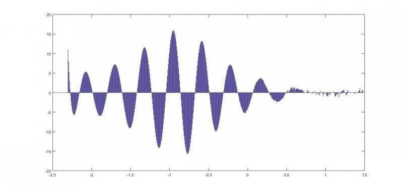

I'm still not sure about how to arrive analytically at the inverse Fourier transform, but I have played around trying to fit a sum of exponentials to F(s), using F(s) values for s from 0 to 10 with a step size of 1e-3 and using 600 bins for the t from 0.005 to 30. The f(t) determined by least-squares fitting looks something like this (log10 scale for the x-axis):

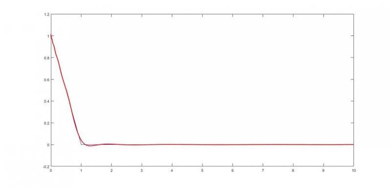

Clearly this looks a lot like a simple wavelet, and presumably summing up to infinity would converge to F(s) exactly. The overlay of the fit to F(s) is below:

Hi Jason, thanks again for the detailed comments, I'll go in greater length tomorrow about the other issues that you have raised, but regarding the sign of f(t), the plot above is probably confusing because it shows log10(t) on the x-axis and the pre-exponential factor in the sum of exponentials I've used to do the fit. So f(t) is zero for t < 0, but can take positive or negative values for t>0 (where the log10 is real).
In other words my simulation seems to suggest that the inverse Laplace transform of F(s) exists and is given by f(t) = A(t) sin (w*ln(t)) where A(t) is the envelope of the wavelet above, and w is the frequency of the wave.
I have thought about the problem, pursuing the sum of exponentials method above, and have realized that adding the faster and slower exponential terms towards log(t) -> ±∞ would not actually significantly affect the behavior of the sum of exponentials around s = 1. The very fast exponentials would only make a difference at very low s, whereas the very slow ones would only make a difference at very high s, therefore the smoothness of the sum of exponentials (red line in plot above) around s = 1 cannot be made into the kink that F(s) displays there no matter how many exponential terms one adds and therefore no sum of exponentials will converge to F(s).
That is to say, as Jason points out, F(s) cannot be expressed as a sum of exponentials or a Laplace transform because it not differentiable (and therefore analytic) at s = 1.
