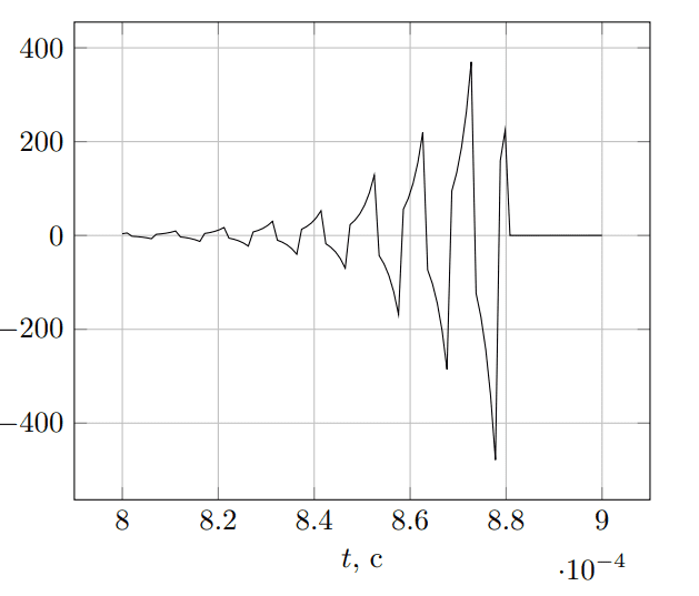

WolframAlpha gives as an answer
$$f(t)= 2^n a^n t^n \frac{_1F_1 (2n;n+1;-at)}{\Gamma(n+1)}, \quad (_1F_1 - \text{confluent hypergeometric function})$$
which seem to work for my original problem, but only for small ##n## (<50). Whenever I go close or above 50 (I use Matlab to plot things) the outcome gets bizarre (##n=50##):

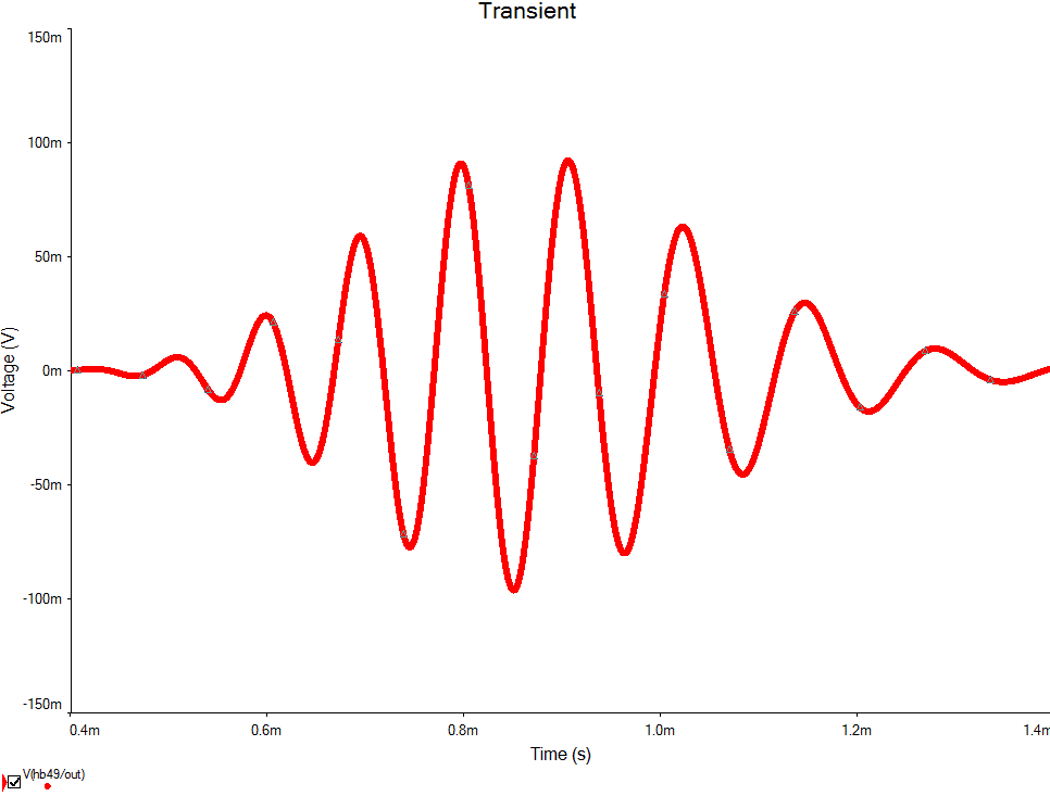

although the actual simulation result (the process which is described by ##F(p)##) looks as it meant to be, smoothly getting to the shape on the following figure (##n=49##).

which I'm not sure is legitimate to use (because of ##n+1## power), yet it yields somewhat fine solution for my original problem (which is strange, because obviously ##F(p)\ne \hat{F}(p)##). I tried to plot it, and for small ##n## it is fine, but Matlab refuses to calculate the derivative (it spits out 0) for ##n>30##, so I cannot check whether it really suits. So my question is whether the Wolfram answer is wrong. I'm not really familiar with the confluent hypergeometric function, so I don't know how to interpret the outcome. What would you suggest to calculate the ##F(p)##? Is it even possible to do in elementary functions? I'd appreciate any help in the solution. I am aware of possibility that my reasoning is wrong, so in case of that let me know. Thank you for help!
