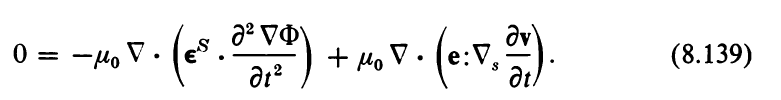

$$0 = -\mu_{0} \nabla \negthinspace \cdot \negthinspace \left( \stackrel{\leftrightarrow}{\epsilon}^{S} \cdot \nabla \phi \right) + \mu_{0} \nabla \negthinspace \cdot \negthinspace \left( \stackrel{\leftrightarrow}{e} : \nabla_{s} \vec{u} \right) $$
Then
$$\nabla \phi = \left( \stackrel{\leftrightarrow}{\epsilon}^{S} \right)^{-1} \color{red}{?} \left( \stackrel{\leftrightarrow}{e} : \nabla_{s} \vec{u} \right)$$
Please see a screen shot of equation from the acutal book.
My query is what would the proper operator in the question mark.

The notation is explained on page 293 equations 8.107 and 8.108.
\mu_0 e : \nabla_S \dfrac{\partial v}{\partial t}=\mu_0 \sum_k e_{ik}\nabla_{kj} \dfrac{\partial v_j}{\partial t}
and similar for the dot which seems to be ordinary matrix multiplication. And where did you get the double arrows from?

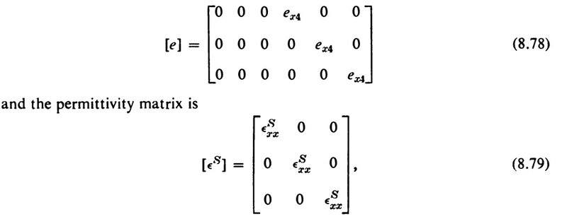

2.) I have this equation to solve for the electric field
$$\epsilon^{S} \cdot \nabla \phi = e : \nabla_{s} u $$
Here,
  • $$\epsilon^{S} $$ is the (3x3) permittivity matrix.
  • $$\nabla \phi $$ is the negative of the electric field.
  • $$e$$ is the third rank tensor.
  • $$u$$ is the (3x3) displacement matrix.
Query: At this point, do I need to use appropriate notation to say that I have used the contracted notation to change the e tensor to a (3x6) matrix, u to a (6x1) vector? What I mean is that do I need to invoke anything at this point to say that I am using full tensor notation, not contracted notation, meaning manipulation of vectors and matrices.
2.) Thanks for pointing the appropriate Equation numbers from the referenced book, ie., Eq.(8.107) and Eq.(8.108); this is using indices.
Query:
  • How would I represent it using the matrix notation? $$ \nabla \phi = \left( \stackrel{\leftrightarrow}{\epsilon}^{S} \right)^{-1} \color{red}{?}\left( \stackrel{\leftrightarrow}{e} : \nabla_{s} \vec{u} \right). $$
  • To the best your study, shall I drop the doube arrow sign on the top for second rank and higher rank tensors?
  • What would I use the question mark place? dot product or matrix multiplication?
