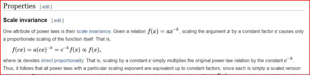

Sorry for my dumb question, but this seems a bit confusing to me. There are two kinds of "power" that seem to be getting mixed in this question.
There is the decrease in radiant power from a source, which varies as the inverse of the distance squared (not to the power 2.5).
And there is the "power law" which refers to when a quantity varies with a constant exponent relationship:
https://en.wikipedia.org/wiki/Power_law
The constant exponent does not have to be "2" in general, and varies depending on the phenomena being described by the equation.
To me, it is very confusing to mix both concepts together in this question. It implies that somehow radiant power can drop off by the exponent 2.5 instead of 2. In the far field at least, I don't think that can happen. Can it?
