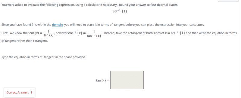

Evaluate and express your answer in radians:
$$cot^{-1}\left(1\right)$$
I start by identifying that the domain of Arccotangent is all real numbers. So 1 is in the domain.
From here, I looked at the unit circle and saw that ##\frac{π}{4}## has a cotangent of 1, but this was incorrect.
So I pulled out my calculator and evaluated ##\frac{1}{arctan\left(1\right)}##
However, if you'll look at my attached image, the step-by-step instructions say that ##cot\left(x\right)=\frac{1}{tan\left(x\right)}## BUT ##arccot\left(x\right)≠\frac{1}{arctan\left(x\right)}##
Why is this true?

This is a terrrible problem, at least from what I can see in the screen shot you posted. At the beginning, it asks you to evaluate ##\cot^{-1}(1)## rounding the answer to four decimal places. The exact answer is ##\frac \pi 4##, or rounded, it is approx. .7854.
The answer they show at the bottom of the screen shot is not the answer to the question above, which is at least misleading.
If ##x = \cot^{-1}(1)##
then ##\cot(x) = 1##
so ##\tan(x) = 1##, and it is this 1 that they expect you to put in the box, at least based on what they show is the correct answer.
However that is not the value of ##\cot^{-1}(1)## -- the equation ##\tan(x) = 1## is just an intermediate step.

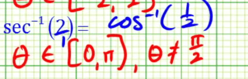

Just found on that website a problem almost identical to the last one I posted. Please see attached image. This seems like a contradiction to the screenshot of my first post.
So let me ask this question- Is the following a true statement?
##arcsec\left(3\right)=arccos\left(\frac{1}{3}\right)##

##sec(x)=2## then ##1/cos(x)=2## then ##cos(x)=1/2##
##x = sec^{-1}(2)## and from the second one ##x = cos^{-1}(1/2)##
And you can see how it works.
Likes opus
