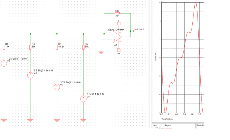

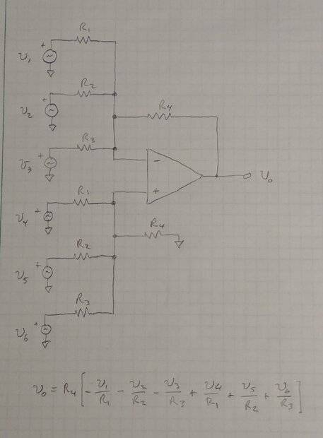

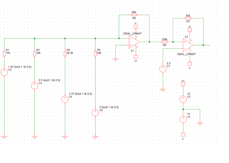

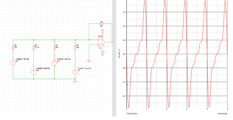

I’ve been asked to create a sawtooth wave form with four input voltages. After doing this I then added a second op-amp to both change the range of the wave form from -/+5v to -/+2.5 and DC offset of 2.5v to create a wave form that ranges from 0v – 5v as required by the question. For the most part I think I’m close enough with my result apart from the second op-amp seems to of “flipped” the wave form and I can’t quite figure out why and how to solve the issue.
I've included a picture of my circuit, wave form after the first op-amp and after the second op-amp.
Any help would be appreciatedhttps://www.physicsforums.com/attachments/286448https://www.physicsforums.com/attachments/286449https://www.physicsforums.com/attachments/286450

Yeah sorry about that by the i tried to change it but it would not up date. Ae these better?
Likes Delta2, berkeman and .Scott
Whew, much better, thanks!
So you mention synthesizing a "sawtooth" waveform with the 4 voltage sources. You've done a good initial job of doing that, but do they want it to be more like a straight sawtooth instead of stepped? Can you say what you could change/add to the circuit to make it more like a traditional sawtooth?

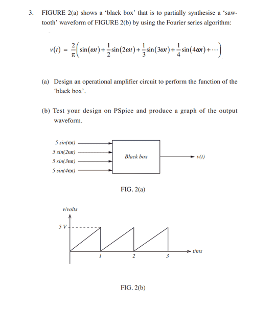

This is the full question as i was given.
Ah, in that case it looks like you are doing the correct synthesis.

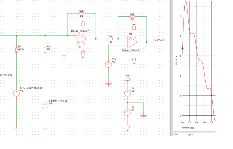

The last op-amp has positive feedback. Isn't that going to be a problem?
Likes berkeman
Good catch! I saw that the simulation output for X2 looked reasonable, so didn't check the schematic in detail. But yeah, with the opamp inputs inverted like that I don't see how the simulation isn't just hitting the rails...

I'm pretty sure you're kidding. An opamp with the inputs reversed so that the feedback is postive is a comparator, not a linear amplifier.

Does the output have to be just like fig 2b (going between 0 and 5V) or just similar in shape? Are other DC biases allowed? I take it the input biases all have to be 5V as given. I ran it in LTSpice and got what you got but it's not clear how literal they want it.
Did you consider simply adding a DC current to the AC harmonic currents at the summing input?
That way it provides the offset without needing a second op-amp.

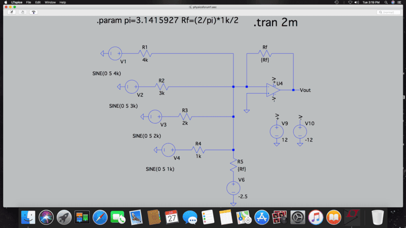

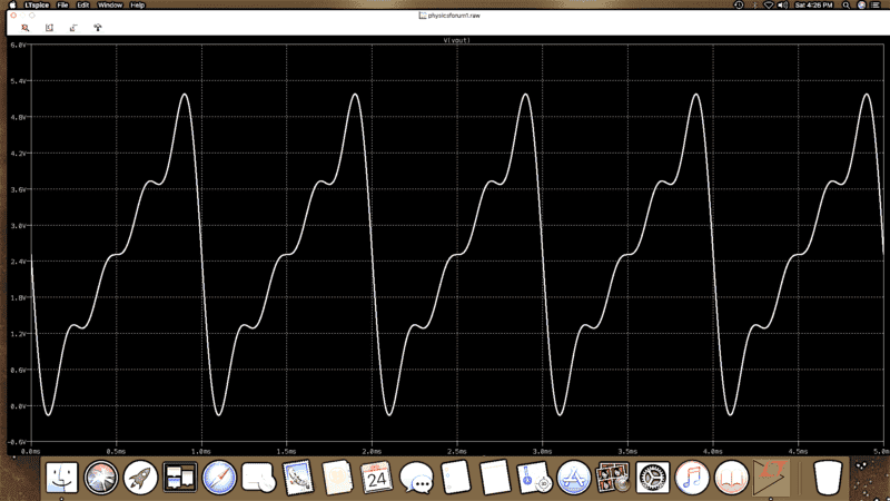

Here is my version of it. I can't get a decent, readable screenshot of the output but it goes between 0 and 5V.
Good work!
A couple of comments: These aren't corrections, more like refinements, like how the pros would do it slightly differently.

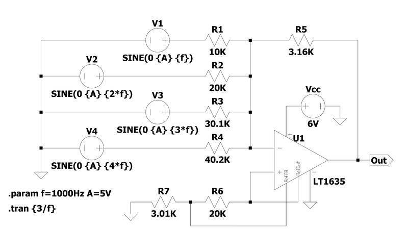

1) It is considered bad design practice* to use the power supply voltages for anything except to power devices. Any connection into the signal path like the offset function you needed in this problem is a bad idea. The power supply voltages (usually) aren't intended to be very precise, they are noisy, and can create some really annoying cross coupling between different parts of the system. For example, if this circuit was used in an audio synthesizer, you would probably have lots of hum, pops & clicks, or and other noise at the output (in addition to your triangle wave) that was injected into your signal path through R6. So, in practice you would add a voltage reference of some sort (Zener diode, IC, etc.) to provide a clean and stable reference voltage for your offset.
* In the real world "bad design practice" means a circuit that mostly works but may have problems like low reliability, poor performance, hard to build, expensive, etc. (i.e there are better ways to do it).
2) It's much harder to buy a 3.5KΩ resistor than a 3.48KΩ resistor. Same for many other common values. Resistors are most often supplied with EIA standard values (usually the 1% tolerance for analog designs, in my experience). This really doesn't matter for homework problems or understanding. Theoretically useless, but how the real world works. Similar to choosing nut and bolt sizes. As an aside, I can usually immediately tell if a schematic was drawn by a very experienced engineer by things like this. You really wouldn't learn about these details until you had to choose resistors from a standard list (your stock room, distributors, etc.). For example, go online to your favorite distributor (I like https://www.digikey.com/en/products/filter/chip-resistor-surface-mount/52) and search for a 3.5KΩ 1% 0805 SMT resistor, see how many choices there are. Then do the same for 3.48KΩ.
3) If you adjusted your offset so that the output didn't go below 0V ever, then there would be no need for a negative power supply, you could replace it with a ground connection. You would have to choose an op-amp that can output 0V though, but these are common.
If you have lots of free time and you want a puzzle to solve, try this design using an LM10 op-amp with it's built-in reference and single supply capability. That might be how I would do it.
edit: These are especially not corrections, since this is clearly an unrealistic exercise. No one actually makes triangle waves by starting with 4 synchronized sinewaves. Even if those sinewaves already existed in my design, I wouldn't use them for this.

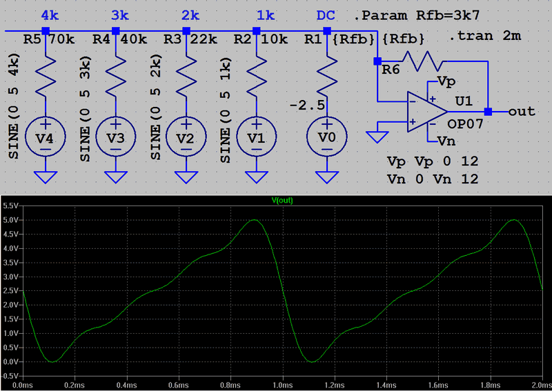

Fourier synthesis of the sawtooth waveform is a difficult exercise because there are so many harmonics, and they fall off too slowly. Saw = f1/1 + h2/2 + h3/3 + h4/4 + h5/5 + , , ,
Notice how, each time another harmonic is added to the synthesis, it inverts and attenuates the error function. Since the number of harmonics is sharply limited, I would attenuate the higher given harmonics so as to eliminate the reversals in slope on the rising ramp. That would slightly increase the fall-time, but it would significantly reduce the error function.
That error function minimisation could also be achieved by including a Miller integrator capacitor across the op-amp feedback resistor, but that might be break the rules of the exercise.
Likes DaveE
Here I have replaced the coefficients {10k, 20k, 30k, 40k} with {10k, 22k, 40k, 70k} to take the bumps out of the ramp.
Likes bob012345

I need a spice model for the LM10. It's not in LTspice. An equivalent part in LTspice would suffice. Thanks.
  • #33
I think you could use any single supply rail-to-rail op-amp model. Then wire it to be like what's inside the LM10.
edit: Use LT1635 it should be in there.

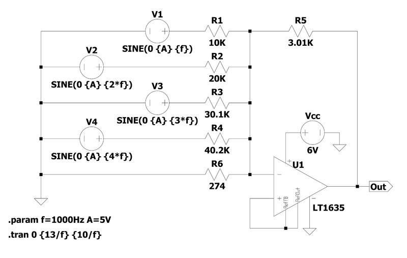

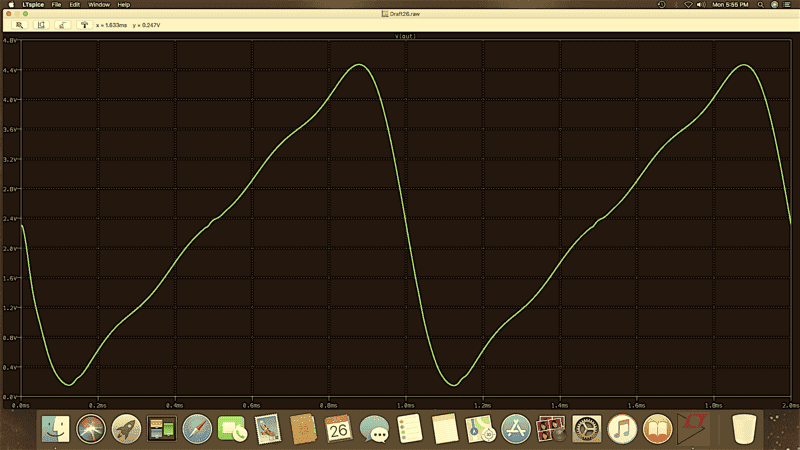

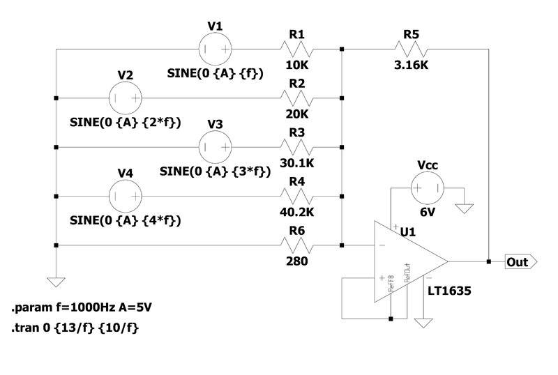

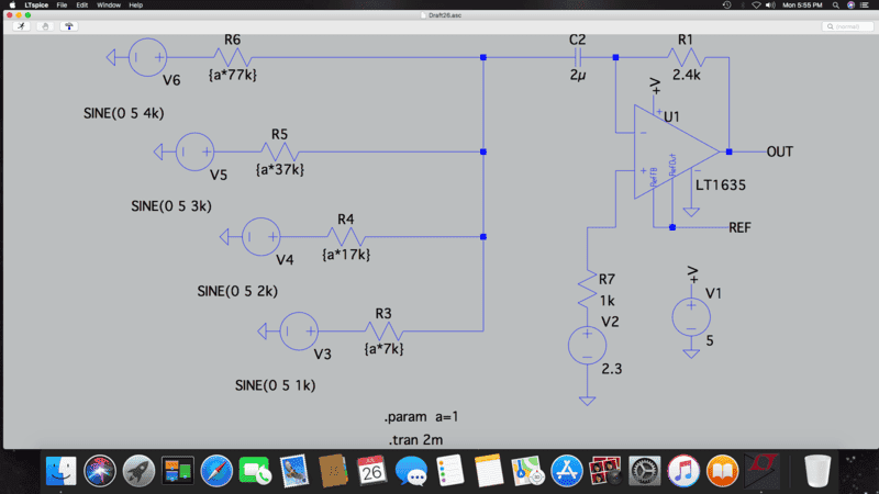

Well, here it is with the LT1635. I could not get to 5V because of the limitations of the op amp I believe. I had to add the capacitor also. I tweaked the resistors further but I think it is not in the spirit of the exercise. Looking at the literature, this class of op amps has a lot of sophisticated uses and using it for a simple problem such as this I think is overkill. Still, it's fun to try.
Also, I'm working on a completely different approach so please don't spill the beans just yet.
Thanks.
