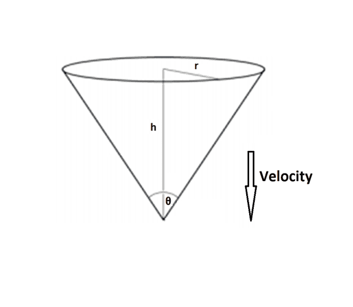

Hi,
I have been doing an experiment at school looking into how the angle of a cone affects the time it takes for it to fall 2m. The data consistently shows an inverse relationship but it is unclear whether or not they are inversely proportional i.e. if the angle doubles, the time taken to fall halves. I wanted to see if I could relate the angle of the cone to the force of drag in some way and wanted to know if someone could help me?
The drag equation we are given is:
FD = CDApv2 (FD = force of drag, CD = drag coefficient, A = cross-sectional area, p = density of fluid, v = velocity)
From looking at the equation I am thinking that the angle of the cone will affect the cross sectional area. So I need some way of expressing the cross-sectional area in terms of the angle of the cone so I see what the relationship would be between the angle of cone and the force of drag. Any ideas?

What are you holding constant as you change the angle of the cone?
Yeh good point, I didn't really consider that. I'm holding velocity constant as I am timing it for the last 2m of a 3m fall so should have reached terminal velocity. The density of air is constant. I know that changing the angle is like an indirect measure of cross sectional area. So I'm actually unsure if changing the angle changed the drag force or the drag coefficient or both?
What else are you holding constant as you change the angle of the cone? Is it the same cone canted at an angle? Or is it the same paper rolled up into a pointier cone? Or what?
Is the area of the base of the cone constant?
No it isn't and the cone is actually dropped upside down (i.e. the pointed tip facing down) otherwise it tumbles and the data is awful. The radius of the flat circle I originally cut out is the same. I basically cut 6 circles each with a radius of 6cm. I then made a straight cut along the radius. I then twisted the paper to form a cone. I measured the height of the cone and new radius once twisted to find the angle. I have attached a diagram to show what I mean.
The last one - the same bit of paper rolled into a pointier cone as shown by the attached diagram on post #6.

Ok so in addition to the angle, the frontal area is also changing. I would try and make cones that have the same frontal area (eg same base diameter) and same weight. May need to add ballast to them.
Likes Jimmy87
Thanks. But then I don't see how the angle could be changed. The angle changes as a result of changing the height and base diameter. How can you make cones which have the same base diameter but a different angle?
Modify the height.

Thanks. So should I change my method or not? Seeming as though all variables are constant except for angle (which surely is a function of cross-sectional area) then the only thing to change would be drag coefficient. I didn't actually cut out a wedge, I simply made a cut along the radius (so no paper was taken away). I then moved one side over the other to twist into a cone. This will decrease the original radius and the angle as shown in the diagram. Does it matter if they both change? Because I was thinking I could get an equation for the cross-sectional area - which is just one variable - or is this hard to do? So are you saying you would keep the base area the same but just change the height by cutting out different sized wedges? Because I can't see how you can get the base area and angle the same by cutting out the same wedge? If you did cut out different sized wedges would this not change the mass though?
If you want to keep the area of the base of the cone fixed but vary the angle then you will have to vary both the diameter of the circle you use to construct the cone and the overlap when you roll it up.
If you want to then keep the mass of the cone fixed then you will need to add a enough ballast (sand? chewing gum?) so that each cone masses the same.

Jimmy87 said:
1) The drag equation shows that cross-sectional area is inversely proportional to the square of the velocity (if everything else is held constant). Should I get a graph of y = 1/x2 if I plot terminal velocity against base area of cone. I only ask because the base area is not exactly the same as the cross-sectinoal area in contact with the air since the cone is dropping with its point facing down.
You are on the right lines except the "A" in the drag equation is the maximum cross sectional area (sometimes referred to as the frontal area) which is the area of the base of a cone when it's pointing downwards.
Is there a simple mathematical way to relate base area of the cone to velocity (if it is not inversely proportional to the square of the velocity)?
The drag equation is..
FD = ½ρ CDAV2
At terminal velocity FD = mg
so
mg = ½ρCDAV2
Rearrange to give
1/V2 = ½mgρCDA
The drag coefficient typically depends on the shape of the object so I would expect it to vary with the cone angle. If you keep the mass and cone angle constant then I would simplify the equation to..
1/V2 = KA
where K is a constant = ½mgρCD
If you plot y = 1/V2 and x = A you should get a straight line with slope = K.
You could also consider square rooting both sides and ploting 1/V against R (the radius of the base of the cone). That works because the area is proportional to R2 .
2) At terminal velocity, will the drag coefficient Cd be a constant (as it needs to be if my independent variable is base area of cone and dependent variable is terminal velocity)
Over the narrow speed and size range of this experiment I would hope the drag coefficient Cd is reasonably constant. Over a wider speed range or a large range of sizes Cd isn't constant. eg sub sonic vs super sonic, or model vs full size aircraft.
