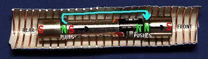

I hope you know the phenomenon called "Magnetic train". My teacher used it in classes to demontrate electromagnetic phenomena. So he told the advanced learners (however, here I am xD) to investigate it, especially the forces and how certain parameters affect the velocity. But I do not understand at all how there can be a velocity with a force? and which forces appear? I hope you can give me at least a thought-provoking impulse.

that´s not what i meant, my experiment refers to a battery in a solenoid where there are magnets attached on each side of the battery. if you put it into, it´ll start to move.
I think the OP is referring to this particular experimental demonstration, where the "train" is a battery with magnets attached to its ends, traveling through a wound copper wire "track".
yes that´s right

My instinct would be that this is due to the back-emf that arises from electromagnetic induction effects...though I'm not that sure...imhomogenous magnetic fields are always tricky to analyse
so it is possible that it gains speed due to the back-EMF and than move till the battery is empty because of the forces.?

mathewmical, I think you should edit your first post to include a picture of that particular experimental demonstration you're referring to, because "magnetic train" immediately causes most people to think about maglev trains =p
okay i´ll do so :D

okay i just got another idea: if i only focus on, like, 3, single loops. if the battery touchs two of them, the current flows and the like pols repel each other with FR, so on the battery there will be twice the force because of Newtons third law. the same with the unlike poles . so all in all there's four times FR so there's an acceleration. then, due to inertia it moves on to the next loop and then it starts again? then its resonable to have an apparently constant velocity. what do you think about it?
If FR refers to friction: why do you expect fixed relations between magnetic forces and friction?
FR refers to the force one magnet exerts on the other one (R due to 'repelling'). maybe if i manage to calculate the force I can figure out the acceleration between two loops.
or wait could it be that first there's an acceleration, but due to the voltage induced by the fixed magnets the voltage of the battery will be compensated so it will remain with a constant velocity?
That´s all? then is there a way to calculate the velocity?
Not with reasonable effort.
You can make rough estimates if you know friction and some coil properties, but it's not like a typical homework problem where you plug in 3 numbers in a formula and you are done.
