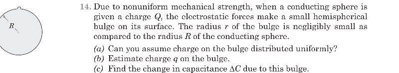

Due to nonuniform mechanical strength, when a conducting sphere is
given a charge Q , the electrostatic forces make a small hemispherical
bulge on its surface. The radius r of the bulge is negligibly small as
compared to the radius R of the conducting sphere.
Can you assume charge on the bulge distributed uniformly?
Charge distribution
In this question it is given that the sphere which is conducting is initially given a charge q then due to nonuniform mechanical strength and due to electrostatic force it creates a Small hemispherical bulge on its surface?
okay my doubt is Let me define a term σ where σ is surface density density so is dq/da going to be constant? And also on bulge part how would the charge distribution be is it going to be uniformly distributed over bulge part? According to me initially when sphere was given a charge q it was uniformly distributed but due to electric forces charges repel each other and create a bulge and I think they should repel each other and settle down in such a way that then also charge will be uniformly distributed only? Is it that?
I am really confused I can't be able to interpret the results? Please help me out?

This is actually the original question.I hope it doesn't have any error.
Oh, it's a little bump, not the whole hemisphere of the overall sphere. Sorry that I misunderstood the question.
Yeah but I am still in determining how would the charge configuration be over the entire sphere including the bulge part and electric field lines direction

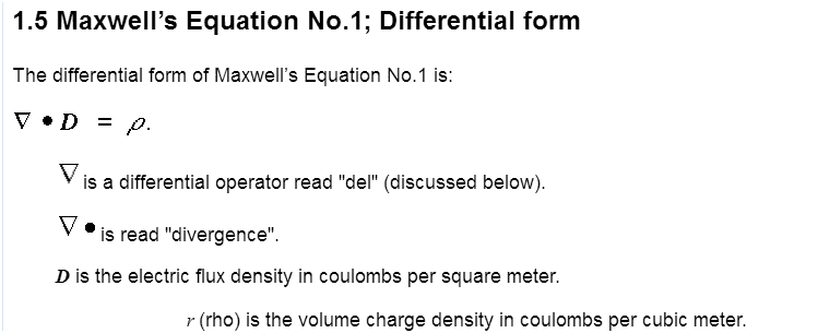

Is the divergence of D higher or lower above the bump compared to the rest of the sphere?
I haven't studied about the divergence yet
