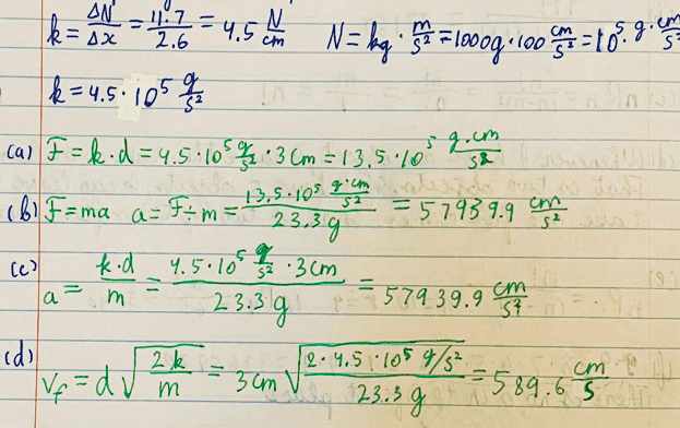

Can you share the students calculations?
How are they calculating the initial velocity of the projectile? To me it seems like it's going to be an involved (to say the least) computation considering sling shot/rubber band geometry)?
Likes nomadreid
Likes nomadreid and MatinSAR
Thanks, erobz. Her calculations are below (if the handwriting is hard to read, I could type them out; she decided to use cgs units). She is only 13 years old, so the theory is simpler at this point (although way ahead of others her age), so of course there will lots of discrepancies from a very rigorous treatment, but I am looking for discrepancies which are huge. The construction of the slingshot is a thick rubber band attached at two points, loosely, to a board, but she shoots the projectile so that it does not make contact with the board. The k that is at the top of the calculation in blue is from data and a graph that I am not including. So, here it is:
Likes erobz

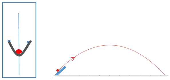

Steve4Physics said:
Was it this sort of slingshot? https://image.dhgate.com/0x0s/f2-al...ooden-style-slingshot-fun-traditional-kid.jpg
Is it possible that there is some sort of confusion between the length of rubber used in the calculation and the length actually used in the experiment?
Thanks, Steve4Physics. The slingshot was essentially the same as the one in your link,, but home-made and a bit clumsier for target shooting
The idea of a mix-up in the distances was an excellent suggestion, but I checked her calculations and found no such mix-up.

nomadreid said:
Thanks, erobz. Her calculations are below (if the handwriting is hard to read, I could type them out; she decided to use cgs units). She is only 13 years old, so the theory is simpler at this point (although way ahead of others her age), so of course there will lots of discrepancies from a very rigorous treatment, but I am looking for discrepancies which are huge. The construction of the slingshot is a thick rubber band attached at two points, loosely, to a board, but she shoots the projectile so that it does not make contact with the board. The k that is at the top of the calculation in blue is from data and a graph that I am not including. So, here it is: View attachment 320756

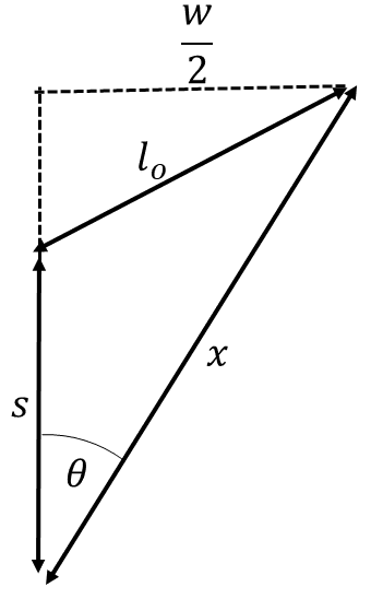

The model I'm coming up with is a absolute bear.
$$ F_{spring_{\parallel}} =2k \cos \theta ( x - l_o) = 2 k \frac{ \sqrt{ x^2 - \left( \frac{w}{2} \right)^2} }{x} ( x- l_o) $$
The work would be:
$$ \frac{1}{2}m v^2 = W_{spring} = \int 2 k \frac{ \sqrt{ x^2 - \left( \frac{w}{2} \right)^2} }{x} ( x- l_o) ds $$
Where ##s## is given by the law of cosines:
$$l_o^2 = x^2 + s^2 - 2 xs \cos \theta = x^2 + s^2 - 2 s \sqrt{ x^2 - \left( \frac{w}{2} \right)^2 } $$
just getting ##\frac{ds}{dx}## is a chore, let alone integrating what follows.
Edit: In retrospect ##s## is found more readily by considering the two right triangles, rather than law of cosines.
It's interesting that turns out to be extremely reducible and give consistent results experimentally with differing material, slingshots, materials etc...

It seems to me ran (d) is wrong. There shouldn’t be a 2 under the radical .
Likes nomadreid
I think there should be.
$$ v^2 = \cancel{v_o^2}^0 + 2 a d = 2 \frac{kd}{m} d \implies v = d \sqrt{ \frac{2k}{m} }$$
Likes nomadreid
$$ v^2 = \cancel{v_o^2}^0 + 2 a d = 2 \frac{kd}{m} d \implies v = d \sqrt{ \frac{k}{m} }$$
a is not constant. The final KE must be equal to the initial stored elastic energy.
Likes nomadreid, MatinSAR, nasu and 2 others

In a rather astonishing (IMO) turn of events all the complexity in #7 cancels!
$$ s = \sqrt{ x^2 - \frac{w^2}{4}} - \sqrt{ l_o^2 - \frac{w^2}{4}} $$
That implies:
$$ ds = \frac{1}{2} \frac{1}{ \sqrt{ x^2 - \frac{w^2}{4}} } 2x dx$$
Subbing that into
$$ \frac{1}{2}m v^2 = W_{spring} = \int_{x=l_o}^{x = x_f} 2 k \frac{ \sqrt{ x^2 - \left( \frac{w}{2} \right)^2} }{x} ( x- l_o) ds $$
We get major cancelation:
$$ \frac{1}{2}m v^2 = W_{spring} = \int 2 k \frac{ \sqrt{ x^2 - \left( \frac{w}{2} \right)^2} }{x} ( x- l_o) ~\frac{1}{2} \frac{1}{ \sqrt{ x^2 - \frac{w^2}{4}} } 2x ~ dx = 2k \int ( x - l_o) dx = k ( x - l_o)^2 \Bigg|_{l_o}^{x_f} $$We now seem to rather simply have that:
$$\frac{1}{2} m v^2 = k ( x_f - l_o)^2$$
Here is the kicker with ##x_f - l_o = d##
$$ v = d \sqrt{ \frac{2k}{m} } $$
The factor of 2 returns! I guess that's why your experiment works!
If I've bungled something let me know.
The good thing about the result (if correct) is this basically narrows it down to being an issue with ##k##, and how its represented. If she doubled up each side like shown in the picture, you get ##k_{eff} = 2 k##
Thus:
$$ v' = d \sqrt{ \frac{2( 2k)}{m} } = \sqrt{2}d \sqrt{ \frac{2k}{m} } = \sqrt{2} v $$
Likes nomadreid
There are some important details missing.
How does ##l_0## compare with w/2? If I were doing the experiment I would have the elastic initially taut, so ##l_0<w/2##. @erobz assumes it is greater.
I see from post #4 that keff was measured by pulling back a distance 2.7cm. But if ##l_0>w/2##, where is that measured from?
What strikes me most is that pretending the force is constant ought to produce a 40% overestimate of the distance.
Edit: no, a 40% overestimate of the velocity, but a 100% overestimate of the distance.
If previous instances of the experiment have not noticed that then there is the possibility that those experiments in some other way underestimated the work, whereas this instance overestimates it in some other way. If so, we are only looking for a second 40% error.
For the shot, it looks like it was pulled back y=3cm. Since ##k_{eff}=2k(1-\frac{l_0}{\sqrt{w^2/4+y^2}})##, if shorter pullbacks were used to estimate keff then it will have been overestimated a little. Maybe prior instances used greater pullbacks for the estimate than for the shot.

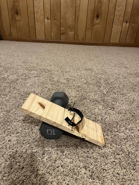

First, thank all those who took part in this thread (my delay in replying has to do with the time zone I live in): erobz, Steve4Physics, ChesterMiller, SammyS and haruspex. (Did I miss anyone?)
The incredibly helpful discussion helped me see the most glaring major error on my part, the correction of which modifies the answer by a factor of sqrt(2) (although erobz's suggestion how that factor might creep back in is intriguing), and I am mulling over the others to see if I can close the gap to the factor of 2. erobz and haruspex also make excellent suggestions about the mystery of why my faulty method produced good results in the past, and I will be mulling these over as well. ("tried and true" was an unfortunate expression on my part. Apologies.)
The glaring error in question was evident when I compared the results of approaching it in terms of energy (1/2) kx2=(1/2) mv2) instead of forces and seeing the remark (made several times) that I was assuming constant acceleration made me realize that the acceleration is not constant, and taking this into account brings the two approaches to the same result even when keeping it on an elementary level. I blush at this elementary oversight.
By the way, erobz's suggestion that I send the student equipment was well meant but the hurdles of the international posts well as the my own limitations of access to equipment make this impractical.
I would be very glad to read further comments (such as addressing erobz's question in post #19), and thanks again!

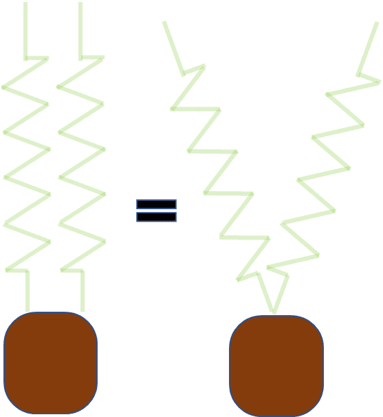

I think I figured it out how these two can be equivalent in terms of work. Namely, they both store energy in stretching a distance ## x - l_o## of:
## U_{s} = k ( x - l_o )^2 ##
The figure on the left reduces to this by:
$$ U_{left} = \frac{1}{2} k_{eff} ( x- l_o)^2 = \frac{1}{2} (2k)( x- l_o)^2 = k ( x - l_o )^2$$
The one on the right does this by the analysis in posts #7 and continuation #17
$$ U_{right} = k ( x - l_o )^2$$
How could they end up doing the same amount of work? Distance. The force acting on the mass on right is reduced relative to the left, but the distance the force acts over is increased relative to the left. This is a result of the triangle inequality:
$$s > x - l_o $$
So, I'm having more confidence for the result of the linear spring model result developed in #7 and #17.

However, we notice that only a single ##k## was used computationally (post #4 part (c)) in the model, namely saying ##a = \frac{k d}{m}##
Implying (either by hook or by crook):
$$v = d \sqrt{ \frac{2k}{m}}$$
These errors cancel to give the linear spring model using COE:
$$ \frac{1}{2}mv^2 = k d^2 \implies v = d \sqrt{ \frac{2k}{m}}$$
That seems to explain how things experimentally agreed with "theory" IMOP ?

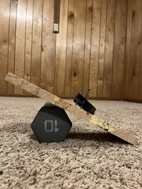

Any chance we can get a picture of the student's actual slingshot?
Likes nomadreid
erobz said:
Any chance we can get an actual picture of the student's actual slingshot?
I will write to her and ask her to send a picture; I will post it when I get it (or the morning after, if it comes while I am asleep).
Likes erobz

  • #31
  • #32
Chestermiller said:
By integrating the actual data up to a displacement of 3 cm, I get a stored elastic energy of 0.231 J and a launch velocity of 4.45 m/s.
The horizontal distance that the projectile went was 116 cm when fired at an angle of 26 degrees to the horizontal. If I have the formula right(?) that the range = (v*sin2A)/g, this works backwards to 14 m/s. Am I doing something wrong here?

  • #34
You mean (v2*sin2A)/g. Also, it looks like at release the projectile is about 2.7cm above the ground, which should add about 5cm to the range.
Feeding 111cm into the formula I get 3.7m/s.
14m/s is 50kph.
Likes nomadreid, Chestermiller and MatinSAR
  • #35
Ok, so this is where the actual geometry of the slingshot could come into play. The scale on the launch pad indicates they are measuring the distance ##s##, when we need ## d = x-l_o## for our formula.
Using Pythagorean theorem, that implies that:
$$ d = x- l_o = \sqrt{ \left( s + \sqrt{l_o^2 - \frac{w^2}{4} } \right)^2 + \frac{w^2}{4} } - l_o $$
We can see by using that particular metric (##s##) slingshot geometry dependence has been introduced.
In general by the triangle inequality, ##s## should overestimate ##d##.
