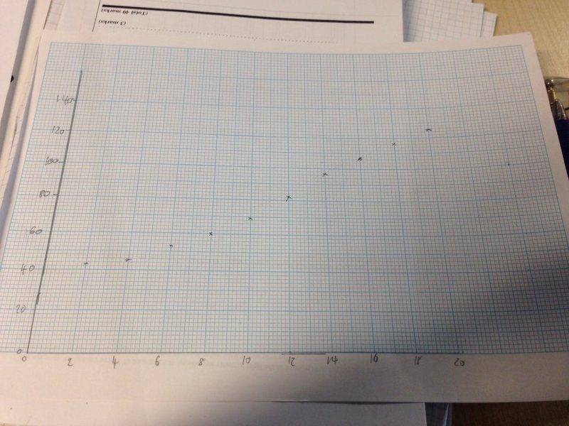

The Graph is nearly a straight line positive correlation where it sort of curves in the positive direction from 2-6cm/20cm, then is pretty much linear, not sure if this is how its meant to be.
The main issue I have is how to find (k), the constant and how to use my results and graph to verify the theory.

I did its in one of the pictures the table of results and now I've added the graph now seems ok. X-axis being the distance between ldr and bulb and y-axis being the resistance in Kohms.
I haven't done the line of best fit yet just until I am sure how it should be

How will you find the line of best fit? If you believe it should be a quadratic, you can plot the y value against x2 and expect a straight line fit.

The straight line portion looks good.
Perhaps the results, for the smallest values of x, should be ignored.
The inverse square law relates to "point" sources, so maybe for the smallest values
of x the results are being skewed by an "extended" source.
