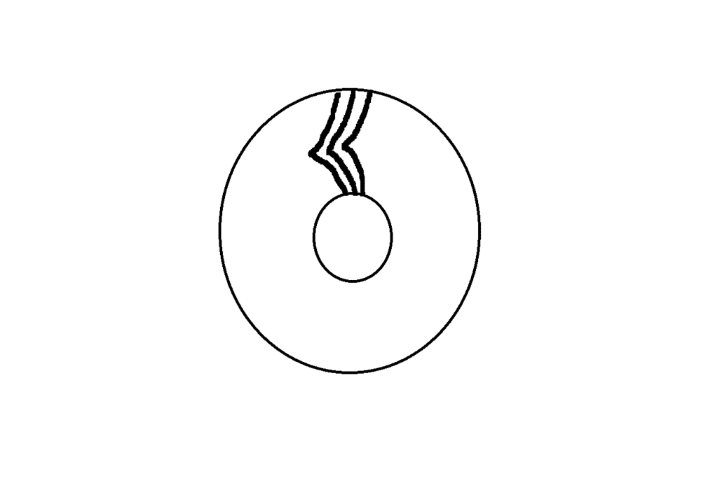

@Cutter Ketch I'm not entirely sure I understood the idea you just said in your last post.
How about if one has a large difference between inner and outer diameter , one can just have the planes involuted to on side then in about halfway from center to rim start the involution angle to the other side?
How about if one has a large difference between inner and outer diameter , one can just have the planes involuted to on side then in about halfway from center to rim start the involution angle to the other side? View attachment 255855
RE my last point, yes, I can see where that may not have been 100% clear. I really need to draw a diagram.
RE your idea of stopping at some radius and beginning a new curve, there are two problems. First, since those are all continuous plates, the number of plates around the circumference doesn’t change at your discontinuity. That being the case, there is only one angle that fills the circumference without changing the gap size. Basically, you can’t do that. Secondly, a plate with a kink like that would be difficult to manufacture.
well difficult to manufacture is not a problem here because I am trying to understand just in theory.
But why should the gap size change in this regard, at the point where the planes change curve the new plane that extends from midpoint to outermost radius could in theory have a different curvature if needed?
See the reactor canister, it basically has two tubes so this midpoint is nothing more than just a wall and after it the next set of planes begin and if my vision serves me correctly they have slightly different curvature and angles , but my point is this, what would change if we discarded the mid wall and simply changed the geometry of the planes midway? In theory I can't see a difference, if I am wrong please point this out to me.
