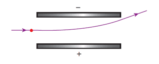

Fundamentally, is the question essentially the same as the simpler case of firing a positive point charge between the plates?
The particle exists the plates with an increase in KE, even though there has not been any change in the energy of the electric field of the plates.
There is no violation of conservation of energy.
This easily extends (pardon the pun) to two oppositely charged particles connected by a blue rubber band that snaps just before exit. ("Ionization")
It wouldn't surprise me if I'm missing the point of the original question.
TSny why would there be no violation of conservation of energy in this case? Where has the energy come from to increase the K.E, if not from the electric field?
What matters is the field energy of the net electric field of all charges. For the single charge ##q## passing between the plates ##\vec{E} = \vec{E}_{pl}+ \vec{E}_q##, where ##E_{pl}## is the field due to the charge on the plates and ##E_q## is the field due to the charged particle. So ##E^2 = E_{pl}^2+ E_q^2 + 2\vec{E}_{pl}\cdot\vec{E}_q##.
If the charge on the plates remains fixed, then any change in field energy of the system is due to a change in ##\int \vec{E}_{pl}\cdot\vec{E}_q \; dV## over all of space.
The value of this integral decreases as the particle passes between the plates which accounts for the increase in KE of the particle.
