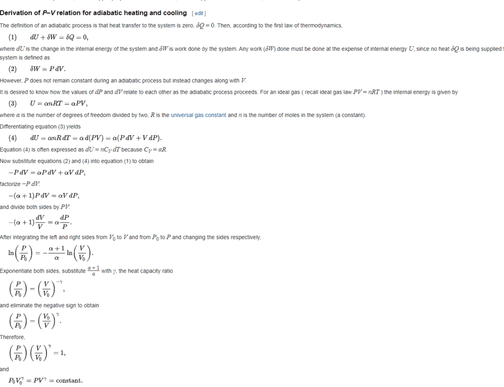

I'm struggling with explanation of part 3. I don't know why they are using adiabatic equation while the gas is constantly heated by condensating vapour. While we are deriving adiabatic equation we use the fact, that there is no additional heat put into the system. Thank you in advance.
Likes JD_PM and etotheipi
Moist air is streaming adiabatically across a mountain range as indicated in the figure.
But from point M1 it is constantly heated by condensating vapour so how it could remain streaming adiabatically?

Ok, but how could they use this adiabatic law? Below I have inserted derivation from wikipedia and they are using the fact that energy is expresed in simple way (nCvΔT) but it's not the case in our example.

They told you to use the ideal gas law, even though some of the water vapor is condensing. This was done as a first approximation to the temperature at point 2. Then, as an approximate correction to account for the condensing water vapor, they added the additional temperature rise of 6 degrees.l. It isn't exact but, oh well.
However is it reasonable approximation? Assuming adiabatic flow we are predicting about 14 degrees change and correction is about 6 degrees, almost as half as first aproximation. Shouldn't such a big heat flow diametrically changed the process?
