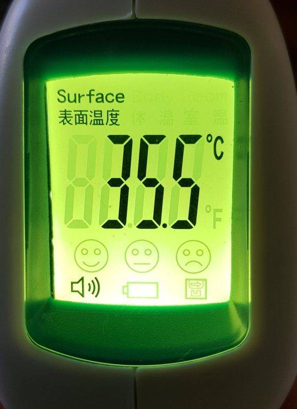

2. Many forehead thermometer has Surface and Body mode. The Surface mode is lower in temperature. I don't think it's just lowering the emissivity. Because in a thermal imager, lowering the emissivity setting will make the temperature higher, not lower.

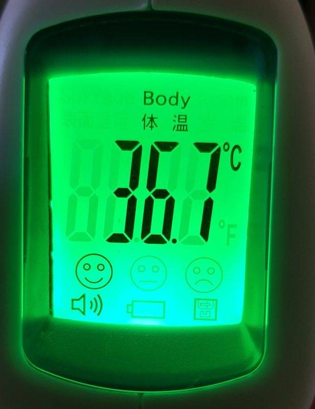

This is the settings in the IR thermometer.
This is pointed to my forehead with Body mode.
This is pointed to my forehead in Surface mode.
What do they have in mind when they lower the temperature when using Surface mode? Its not lowering the emissivity setting which can increase the temperature in a thermal imager.
It's probably an estimate of how much warmer your body is than the surface of your forehead.

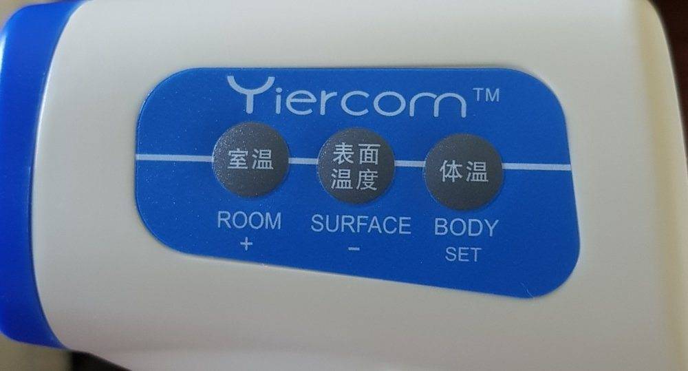

Anyone can understand chinese? What is this definition of Body vs Surface? I saw in youtube Surface is used for objects and Body for human body. My thermal imager doesn't have these settings. It can see both. Why a thermopile needs separate mode than a bolometer (microbolometer used in thermal imager)? :

I'm trying to understand how the algorithm of Surface vs Body mode works. When it's set to Surface mode and you aim it at surface of say the wall, the temperature is lower than the body. I'm comparing to my thermal imager to understand the algorithm and what emissivity adjustments they were doing.
They aren't adjusting emisssivity. You are making this too complicated. Again: Body mode is an estimate of how much warmer the inside of your body is than the surface of your forehead.

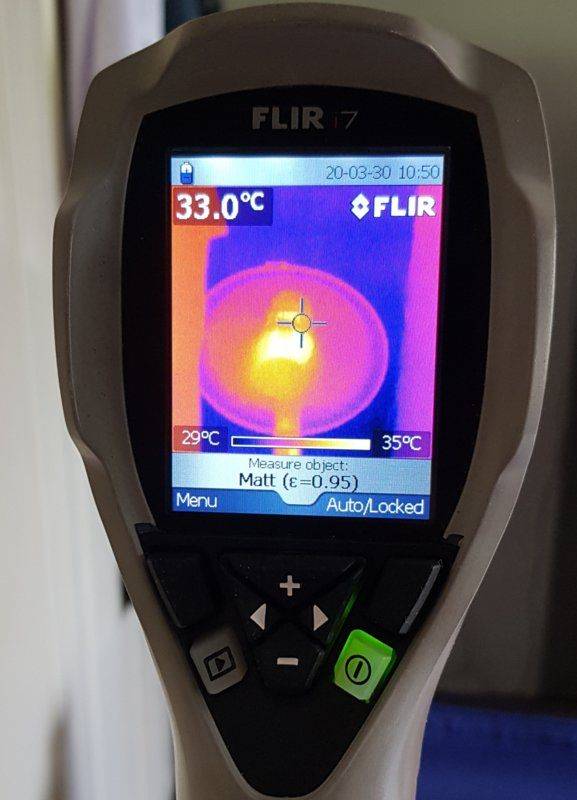

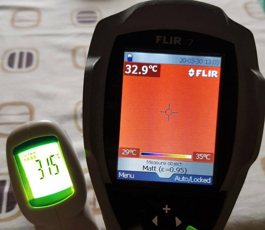

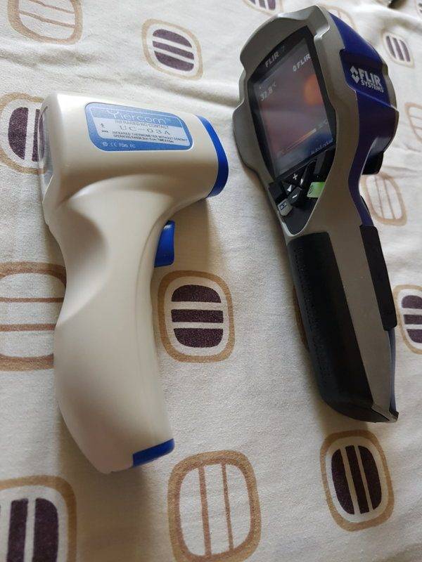

My microbolometer is handheld on the right. The left is the ir thermometer.
This is when i aimed the right on an electric fan.

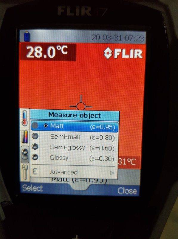

If the above is the case. No problem. But using the thermal imager on a friend. The surface really measures 36.6 C and not 35.5 C.
Hope others who own an ir forehead thermometer presently used in checkpoints all over the world can verify the meaning of Body mode. Or if someone has english manual of it.
Note: a thermal imager like the above doesn't have Body mode. It measures all surfaces only. Only an ir forehead thermometer has Body and Surface mode.

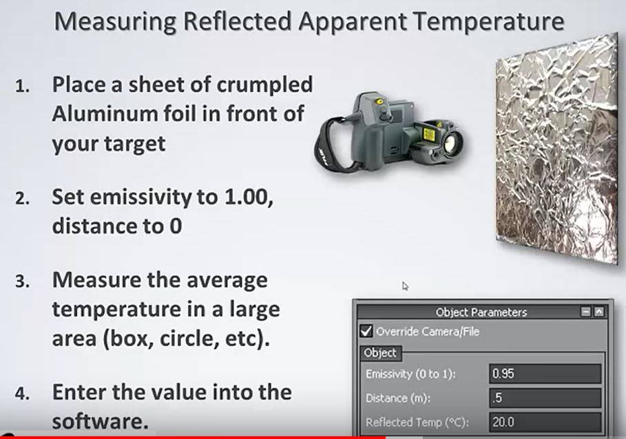

The FLIR thermal imager measures in raw mode. It is for electrical and constructions. But when aimed at a human forehead. It measures 36.6 C which is identical to the smaller IR thermometer unit in Body mode. This gives me idea the Body mode is measuring human body at the surface. And Surface mode is for inanimate objects. In fact most demonstration in youtube explains it that way.
About surface and core temperature of body. I know core temperature is higher but i don't think the ir thermometer is compensating for it. Those who actually own one pls verify. Thanks.

There is high probability russ_walters and Drakkith were right about Body mode being software adjusted and meant for internal body temperature.

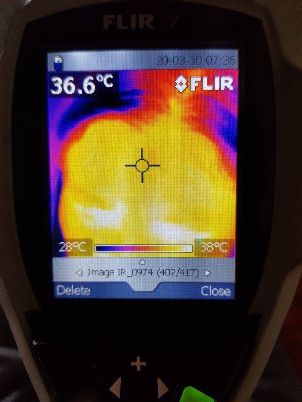

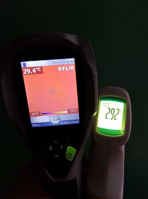

The following is the IR Thermometer at left compared to the Thermal Imager at right. The IR thermometer is set at Surface mode. Notice the reading is lower than the thermal imager when they have the same target.
The thermal imager shows higher reading. Reflecting on it (pun unintended). Notice the emissivity setting of the thermal imager is 0.95. The reading will make sense if the IR thermometer is set to 0.99 emissivity, making the displayed temperature lower.

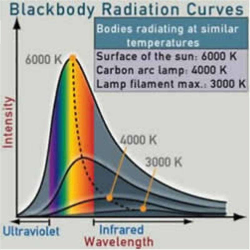

I want to test if the IR thermometer indeed has setting of 0.99 emissivity, any ideas how to test it?
Also I read 100 Celsius temperature corresponds to the peak near 10 micron wavelength. So does this mean all thermal imagers in the world show the same temperature given the target is the same? So the relationship of wavelength from say 7.5 to 14 micron indeed has a tight relationship to temperature and not arbitrary? Example. The sun peaks at yellow light at temperature near 6000K. This is strictly true for much lower temperature, the peak?
How does the curve looks like at say 36 Celsius? Any ideas?
I've read that the emissivity of skin in the IR is above 0.98, so that is consistent what you have found.
You want to look up Wien's displacement law. You can also try out this simulation of a blackbody spectrum to get a feel for how it changes with temperature.

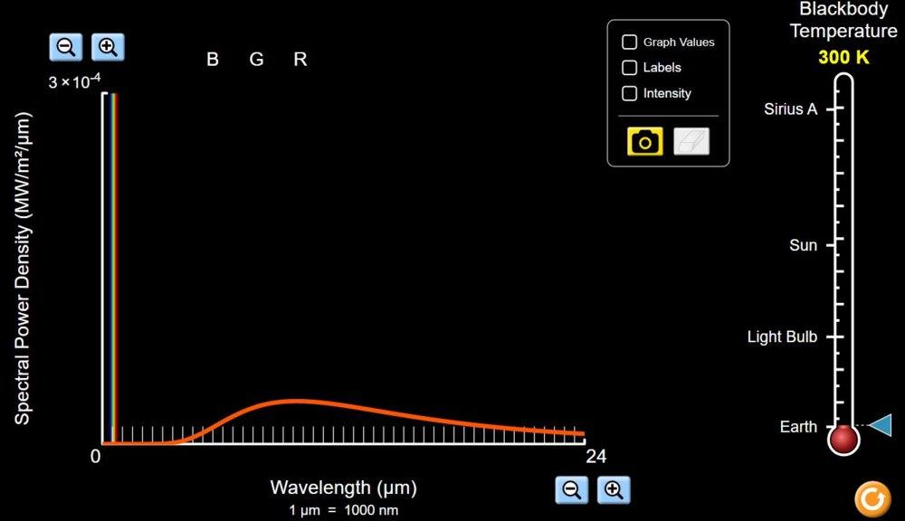

This is the blackbody spectrum at 300k or about 27 Celsius.

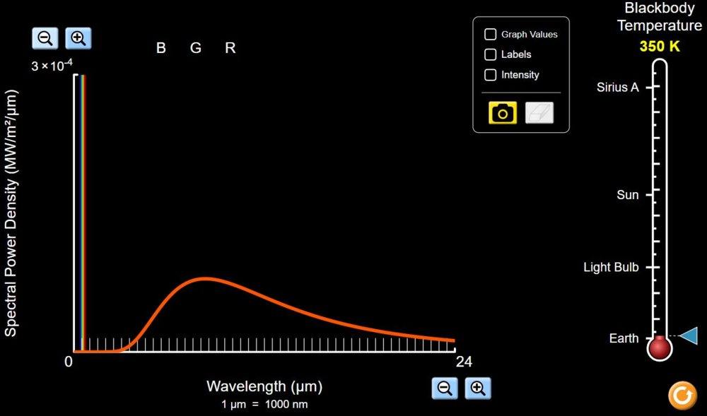

This is the peak at 350 K or about 76.85 Celsius
The peaks are so closed together. How does a thermal imager distinguish between a wavelength of say 10 microns vs 8 microns or between 1 Celsius or so? A microbolometer has a range of 7.5 microns to 14-microns wavelength. There are no obvious peaks corresponding to those wavelengths.
Unless it is detecting the intensity of the overall radiation and not the individual peaks? More intensity more radiation and the microbolometer has to be calibrated?

(Btw.. you are probably right about the Body Mode using software to increase the temperature a bit to account for internal body temperature. In the above. I was only considering surface temperature for both the IR thermometer and thermal imager. We are not talking about Body Mode anymore).
chirhone said:
Now imagine you are aiming each of them to a surface (such as the wall). The IR thermometer with one large pixel will scan the temperature of the wall versus the Thermal imager with many small pixels scanning the temperature of the wall. Could this result in some changes in the temperature between them since the intensity of each differs? Or the same?
In the end, if you do not want image resolution, the sum of the outputs from a number of small sensors is effectively the same as the total output from a single sensor of the same area so there's no point. If you need to detect a small power flux then it may be cheaper to have a single big sensor and a body thermometer can expect a known amount of power flux over the normal range of temperatures within the proper distance. For a thermal imaging camera you can get the advantage of using a lens which will have more light gathering power and this increase sensitivity (i.e. signal to noise ratio).
Likes chirhone

Oh. I realized fluxes can be numerous or few but it is independent of the wavelength, so i guess it won't accept the temperature if more fluxes reach your sensors. Also:
https://en.wikipedia.org/wiki/Wien's_displacement_law
"Wien's displacement law states that the black-body radiation curve for different temperatures will peak at different wavelengths that are inversely proportional to the temperature. The shift of that peak is a direct consequence of the Planck radiation law, which describes the spectral brightness of black-body radiation as a function of wavelength at any given temperature."
  • #35
You are confusing me now. What is the bit about "more fluxes"? There seems to be a problem in translation??
Also, Wien's displacement law can only be used if there is spectral analysis of the incident radiation. A post higher up suggests that the resolution could be difficult to resolve the spectrum of a body at 300K with a simple device.
152
