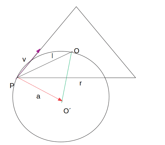

The thing is, I've already looked up at the solution online at it's t= 2a/3v. But I've approached it a different way and I can't really tell what I'm doing wrong, my solutions gives out t= (a/√3v )* (π/3),I don't know what's wrong with it. Here's my approach:
The points will meet at the centroid of the triangle, at distance l= a/√3 from the points, and their trajectory will be curved.
Argument 1: Since the modulus of the velocities isn't changing but the direction is, there must be a centripetal acceleration and the trajectory is a segment of a circle of radius r. Therefore acceleration (and position vector from the center of the circumference) must be perpendicular to v.
By using the fact its an equilateral triangle, we find that POO' is an equilateral triangle as well therefore r=l. Distance traveled by the point is (π/3)*r.
vt=(π/3)*r.
t= (π/3v)*r.
t= (a/√3v )* (π/3)
Please help, I have no idea what's wrong with my approach. Thanks
Only if the centripetal acceleration is constant.
Likes Charles Link
Thanks, for the feedback. That makes a lot of sense, but how can I know for sure the centripetal acceleration isn't constant?
Try computing ## \frac{d \phi}{ds}=\frac{1}{r} ## where ## r ## is the instantaneous radius of curvature, and you will see it is not constant. If it were, the problem would be fairly simple.
The best I can tell, this one is a spiral, but I haven't solved it yet.
I computed the above by taking the instantaneous length ## l ## of the side of the triangle, (the scenario is always an equilateral triangle that will be rotating and shrinking), and computing the ## \Delta \phi ## that results from a ## \Delta s ##. The result I got is that ## \frac{\Delta \phi}{\Delta s} ## is inversely proportional to ## l ##.
Note: ## \phi ## is the angle (w.r.t. the horizontal) of the velocity vector of a given vertex.
The point, surely, is that you have not shown that it is.
Likes Charles Link
I just solved it now. It is kind of simple in a way=you don't need to compute the trajectory. Instead, similarly to computing ## \frac{\Delta \phi}{\Delta s} ##, you compute ## \frac{\Delta r}{\Delta s} ## for the instantaneous triangular case. It's simple trigonometry. The integrated ## \Delta r ## is just the length of the vertex to the centroid. The integrated ##\Delta s ## follows immediately. ## \\ ## The trajectory is not a circle=I was able to show that with the ## \frac{\Delta \phi}{\Delta s} ## computation, but any solution computing an arc length of the path by using the exact trajectory is likely to be very difficult.
Thanks a lot guys, and yes I did see the solution online using relative velocity along the line, It's just that I couldn't figure out why my solution was wrong. I have more clarity now, I'll be more careful next time when assuming things!
Likes Charles Link
It was a good guess, although incorrect, to think it might be a circular path. I think the computation of the exact path on this one might prove very difficult. [Edit: See post 11 for the exact path.] I was able to show the acceleration would be position dependent, and the form was not simple.

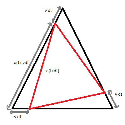

You can consider ##a^2(t+dt)=(v\,dt)^2+(a(t)-v\,dt)^2-2(v\,dt)(a(t)-v\,dt)\cos(\frac{\pi}{3})## (cosine rule) and try to find the rate of change of ##a(t)## using the formal definition of a derivative.
$$\begin{align*}
a^2(t+dt)&=(v\,dt)^2+(a(t)-v\,dt)^2-2(v\,dt)(a(t)-v\,dt)\cos(\frac{\pi}{3})\\
&=(v\,dt)^2+a^2(t)-2a(t)(v\,dt)+(v\,dt)^2-a(t)(v\,dt)+(v\,dt)^2\\
&=a^2(t)-3a(t)(v\,dt)+3(v\,dt)^2
\end{align*}$$
Bring the ##a^2(t)## to the other side and remove infinitesimals of higher orders:
$$\begin{align*}
a^2(t+dt)-a^2(t)=-3a(t)(v\,dt)&\Leftrightarrow\frac{a^2(t+dt)-a^2(t)}{dt}=-3va(t)\\
&\Leftrightarrow 2a(t)a'(t)=-3va(t)\\
&\Leftrightarrow a'(t)=-\frac{3v}{2}
\end{align*}$$
The side length is decreasing with ##da=-(3/2)v\,dt## each ##dt##, so, if you sum all the decrements, you will obtain the negative of the length, or:
$$a=-\int_0^{t_f}a'(t)dt=\int_0^{t_f}\frac{3v}{2}dt=\frac{3v}{2}t_f\Leftrightarrow t_f=\frac{2a}{3v}$$
Likes Charles Link
I would like to add:
The angle in the cosine is constant since the particles will move towards each other by the same amount and in the same way in an infinitesimal time, i.e the triangle they form is always equilateral.
Likes Charles Link
