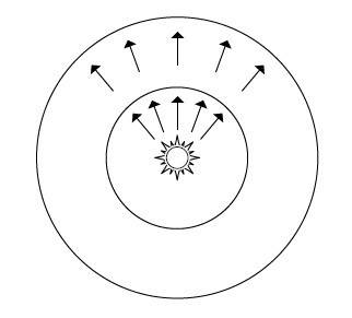

In summary, the formula for irradiance on a sphere is flux divided by 4π times the radius squared. This gives the amount of energy per unit of time that passes through a specific area on the sphere. The dimensions of the point are not relevant, except when an infinitesimal surface is drawn around it to determine the value at that point.
Pilpellon
My book states that "irradiance at a point on the outer sphere is less than irradiance at a point on the inner sphere."
The formula is simple, it's flux/area. So in case of a sphere its flux/4π*r^2.
But my question is what exactly does this formula give? does it give the total flux that arrives on a point on the sphere? If so, what are the dimensions of that point? The book totally confused me on that part.
power or flux (energy/time) per area = irradiance
It gives you how much energy per unit of time passes through some area.
No point is concerned, except for if around that point you draw an infinitesimal surface. So you can determine its value at those points.
