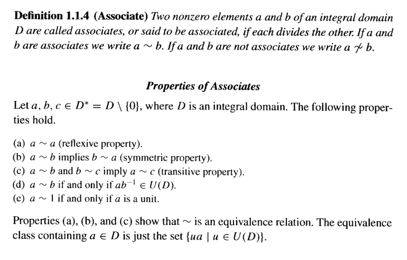

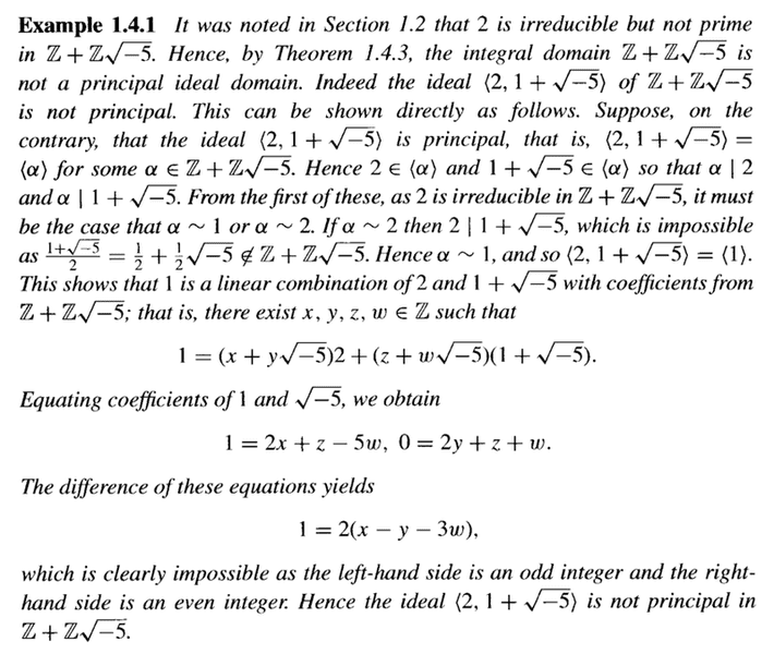

I am reading "Introductory Algebraic Number Theory"by Saban Alaca and Kenneth S. Williams ... and am currently focused on Chapter 1: Integral Domains ...
I need some help with understanding Example 1.4.1 ...
Example 1.4.1 reads as follows:
In the above text by Alaca and Williams we read the following:
"... ... From the first of these, as ##2## is irreducible in ##\mathbb{Z} + \mathbb{Z} \sqrt{ -5 }##, it must be the case that ##\alpha \sim 1## or ##\alpha \sim 2##. ... ...
My question is as follows ... how does ##2## being irreducible imply that ##\alpha \sim 1## or ##\alpha \sim 2##. ... ...?
Hope someone can help ...
Peter================================================================================NOTEThe notation ##\alpha \sim 1## is Alaca and Williams notation for ##\alpha## and ##1## being associates ...
Alaca's and Williams' definition of and properties of associates in an integral domain are as follows:

Math Amateur said:
My question is as follows ... how does ##2## being irreducible imply that##\alpha \sim 1## or ##\alpha \sim 2##. ... ...?
##\alpha \mid 2## means ## \alpha \cdot q=2## for some ##q##. Now irreducibility of ##2## implies either ##\alpha ## or ##q## is a unit. If ##\alpha ## is a unit, then ##\langle 2, 1+\sqrt{-5} \rangle = \langle \alpha \rangle = \mathbb{Z}+ \mathbb{Z}\sqrt{-5}## which is wrong since it doesn't contain, e.g. ##3##. Now if ##q## is a unit, then ##\alpha = 2 \cdot q^{-1} \mid 1+\sqrt{-5}## which means ##2 \mid 1+\sqrt{-5}## which is also wrong.
It is simply the definitions that are used. You should try to find those things by yourself. It's always a matter of practice. If you will have done it several times, you will start to "see" things more quickly. As a general advice: always try to use what's given, here that ##\alpha \mid 2## and ##2## cannot properly be written as ##2=a\cdot b##. Part of the fun reading those books is to read them as a book of riddles where you're supposed to solve them. A bit like solving crosswords if you like.
