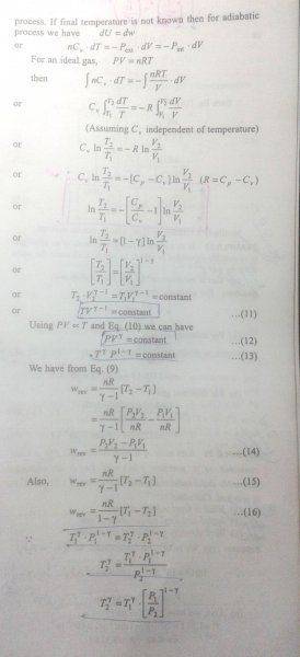

I think for derivation of PVγ = constant for adiabatic expansion,
We take ΔU = -W,
⇒ nCvdt = -P dv = - (nRT/V) dv
The fact we are taking P = nRT/V is incorrect in irreversible I guess. Is that correct?
Yup... I think you are (absolutely) correct. If in the question its not given that the equilibrium pressure is equal to the external pressure then ideal gas equation can not be applied on this pressure. More over we have to equate external pressure to the internal pressure to derive the result of option D. Derivation (of my book ) is attached in which this step is performed.

d is true only for an adiabatic reversible expansion, where Pext=P. It is not true for your irreversible adiabatic expansion. Solve the problem for the adiabatic irreversible expansion, and you will see that the answer is different.

Thanks, the derivation part I know already.

You can't use the ideal gas law for all the states that the gas passes through as it expands, but the initial and final states of the gas are thermodynamic equilibrium states, so you can use the ideal gas law for those. Also, you've already been told in the problem statement that Pext=0 during the expansion, so you know immediately that T2=T1. From this, you can determine P2, which is not the same as Pext, since, once the expansion is manually constrained to end at V2, the gas pressure re-equilibrates to P2. Pext=0 is present only during the expansion.
