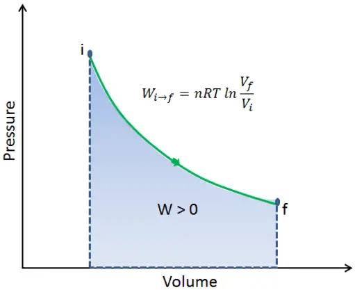

Sketch a PV diagram of the process. Do you know what an isotherm looks like for an ideal gas?
Something like this correct?
Looks like you've found the way!
Aurelius120 said:
How external pressure becomes ##2\ bar## and ##1\ bar## is beyond me.
A slow compression expansion.
Aurelius120 said:
It also seems wrong that ##P_{ext}## should change in an irreversible process?
A dramatic example would be an explosion.
