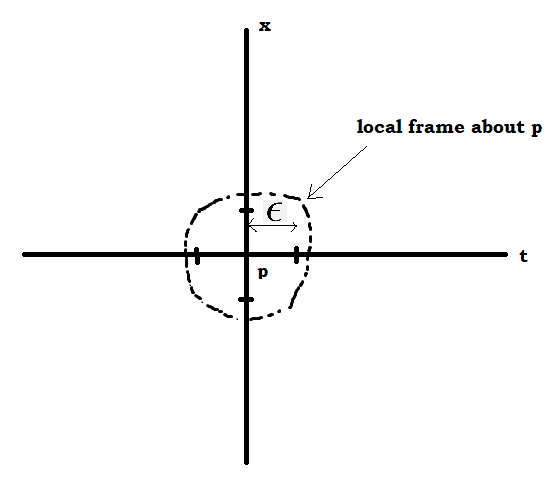

I'm picturing a "local reference frame at some event ##p##" like this: a 4D spacetime coordinate grid with origin ##p## and the axes extending up to a very small value ##\epsilon## about the origin. Something like this (sorry for the crude drawing):
For this, if ##\epsilon## is small enough, then the curvature effects up to first order at least are small enough to be ignored. Is that right?

So even in a tiny region of spacetime, the metric tensor itself and its first derivative won't vanish completely - they'll just be so small that they can be practically ignored.
The metric tensor never vanishes. In Riemann normal coordinates it will be the Minkowski metric at the chosen event, and the first derivatives will be zero at that event. As you move away from that event, differences of the metric from Minkowski, and of the first derivatives from zero, will be second order in the coordinate differential from the chosen event.
Shirish said:
For this, if is small enough, then the curvature effects up to first order at least are small enough to be ignored. Is that right?
Curvature effects are never first order. They are second order. Differences in the metric from Minkowski, and its first derivatives from zero, are second order, so up to first order they are zero.
