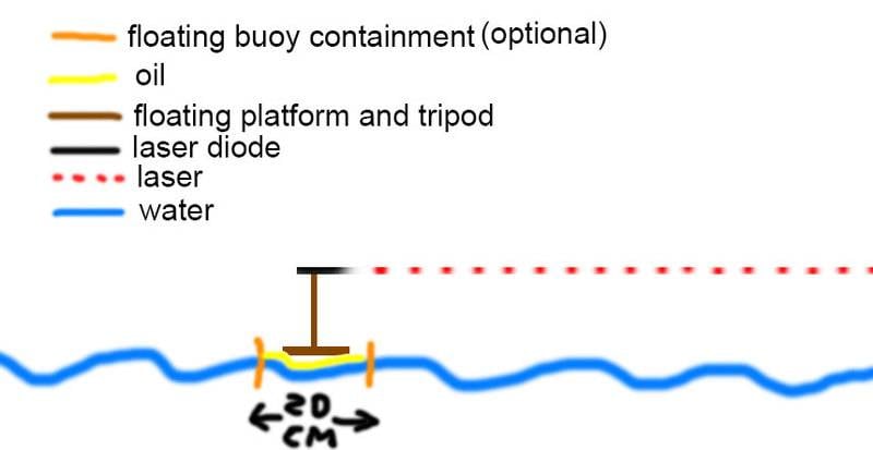

Do you think it's possible for an object to be relatively motionless if floating on rippled water surface?
Could this be achieved by have it float inside one (or several nested) water/oil-containing containers?

What is the reality of the problem ? Can you gives us a sketch and some order of magnitude dimensions ?
There are certainly methods of at least partially stabilising floating bodies in specific situations .

You're right, of course here it is.
[Questionable link deleted by moderator. See the image in post 9 instead]
Basically just a small-ish floating stand.

There are waves with wavelengths much longer than 20 cm. Your device will follow those waves, the details of its construction do not matter.
Are you allowed to use a damper? Something like a large horizontal flat sheet of metal on a pole well below the float.
