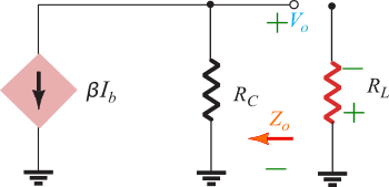

Hi,
I'm trying to find the output voltage of a load attached to the output of a common emitter amplifier. The collector is represented as a current controlled source. Attached to current source are two resistors, ##R_{C}## and ##R_{L}##.
The circuit is already in Norton's equivalent circuit form. The two resistors ##R_{C}## and ##R_{L}## are in parallel with the current source.
Now transform the circuit into its Thevenin equivalent circuit. From the perspective of ##R_{L}##, ##R_{th}=R_{C}##, meaning the same resistors that were in parallel now appear in series with the voltage source.
Now the conundrum :
1. Norton Circuit : If ##R_{C}=\infty##, the current source gives all its current to ##R_{L}##.
2. Thevinin Circuit : If ##R_{C}=\infty##, No current flows in the circuit.
So what's going on ??
Amplifiers that want to pass on most of their voltage have low output impedance. In a Common Emitter amplifier, the output impedance is approximately ##R_{C}##. The thing is when you look at it from the perspective of the Norton equivalent circuit, it seems that with a very large ##R_{C}##, almost all of the current is through ##R_{L}##, meaning ##R_{L}## voltage drop is high. So here it seems that large ##R_{C}## is good. From the perspective of the Thevenin equivalent circuit, a very large ##R_{C}## will take all of the voltage by virtue of its size since its in series with a smaller ##R_{L}##. So here, it seems a small ##R_{C}## is good.
I was reading a book on amplifier design when I was surprised when the author converted a Norton Circuit to a Thevenin circuit for him to declare that a small output impedance is desirable to pass on the voltage. Something weird seems to be going on !
Please tell me where I'm wrong.
Thank You.

I don't really understand what you're saying. Here's the circuit as it looks from in Norton's form. ##R_{C}## is the output impedance. Clearly in this form, a large ##R_{C}## means that most of the current is flowing through the load meaning that a large output impedance is fine. But I know that is wrong. The question is why ?

I think no one really understands my question. My question is with Norton's theorem a large output impedance seems better whereas if you transform the same circuit to Thevenin, a small output impedance seems better. That is my question. Why the same impedance is better in one case and bad in the other case when the two circuits are the same circuits.
Please don't be telling me again what Thevenin or Norton means or which one is easier to use. I have solved enough problems to know which one I prefer.
But this is not about Thevenin/Norton. But about ideal voltage source and ideal current source.
Ideal voltage should have 0 ohm internal resistance. If not the output voltage is not equal to source voltage (see voltage divider).
In case of a ideal current source, the internal resistance of an ideal current source should be equal to infinite. If not the output current is not equal to source current (current divider).

Let's consider a voltage source of 10V having an impedance of 0.1 Ω
Ideally, when we connect a load, or vary the load, the voltage across the load won't change much. So we'd like the Thévenin resistance to be small in order that changes in load cause only small changes in load voltage.
Let's study the Norton equivalent, viz., a 100 ampere source having a parallel resistance of 0.1 ohms. Is that low resistance desirable? Most definitely! The low parallel resistance means that when you cannect a load, or vary the load, there is not much change in the current through the 0.1 ohms. No change in the current through the 0.1 ohms means no change in the voltage across it and therefore no change in the output voltage, and isn't that what we want in a good voltage source: no change in load voltage even though there may be changes in the external load!
So when you model a good voltage source using its Norton equivalent, it's desirable that it have a low Norton resistance.
