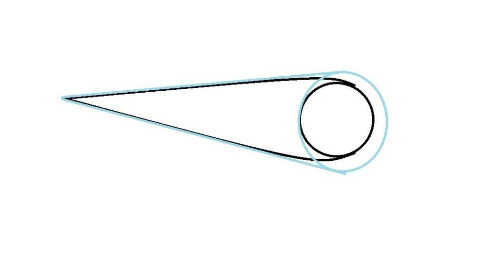

Draw a diagram tracing a ray of light from the right edge of the star to the viewer's eye. Repeat for the left edge. The light rays should each follow a path roughly like one half of a hyperbolic orbit, concave inward toward the star.
Now trace two straight dotted lines back from the eye, each tangent to the path on which one of the two rays arrived. Draw in a dotted image of the star where the straight dotted lines end near the position of the real star. That dotted image is the virtual image that is seen.
Is it larger or smaller than the real star?
Likes Forreal and Ibix
Smaller.
Right?
"So the statement gravitational deflection makes the Sun appear smaller than if there were no gravitational deflection" is true?
Forreal said:
Smaller.
Right?
Did you draw the picture?
Tried my hand with mspaint. Black is original star. Blue is projected sight lines and virtual image.
Well, I tried.
I think I mixed up concave and convex.
Thank you! Very appreciated.
jbriggs444 said:
Tried my hand with mspaint. Black is original star. Blue is projected sight lines and virtual image.View attachment 256643
It's always good when someone actually bothers to draw a relevant diagram. :smile:

The rightmost rays visible to the eye are, naturally, the rays that left the rightmost edge of the star (*). As drawn, actually a tiny bit back from there due to the deflection. These are the rays that left the sun at a grazing angle. [If the angle were not grazing then there would be a viable trajectory even further right and intersecting the surface of the sun even farther back]
(*) Yes, we both know that this will be on the left edge of the inverted image on the retina.
This diagram differs from those that one would typically use when trying to present geometric optics using ray tracing through lenses. In those drawings, a typical feature is a trace of two different trajectories (e.g. through each rim of a concave lens) from a single point on the object to a single point on a real image. This drawing is just portraying sight lines -- one ray trace from one point on the object to the viewer's eye and another ray trace from another point on the object to the viewers eye. That is enough to determine the subtended angle. Subtended angle is the relevant feature, of course.

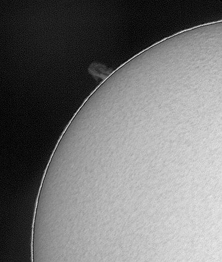

PS I managed to get a result with a second hand Coronado PST solar telescope yesterday. I could see a flare that must have been at least 40 thousand km high. Makes you think dunnit?
Likes jbriggs444
sophiecentaur said:
I could see a flare
a prominence :wink:
yes, there was a decent one there
Hah. Whatever. It was still pretty big.
I must buy an observer’s book of the Sun. Then I can give you a fair fight. 😜
