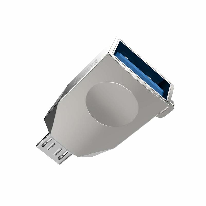

I found another similar adapter on Amazon if anyone was interested in examining that one as well,
https://www.amazon.com/gp/product/B07SPXHL97/?tag=pfamazon01-20
I only looked at this one. Nowhere does it claim 5Gb/s xfer rate.
Thank you for your response to the second device, although I didn't see the amazon one mention this feature, I wasn't sure so I thought it would be worth mentioning as well since it is a USB A 3.0 female to a Micro B male adapter like the first device.
