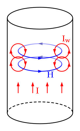

I have looked skin effect on Wikipedia and got the main idea, but there is something made me curious. The following is what I got from Wiki.
Conductors, typically in the form of wires, may be used to transmit electrical energy or signals using an alternating current flowing through that conductor. The charge carriers constituting that current, usually electrons, are driven by an electric field due to the source of electrical energy. An alternating current in a conductor produces an alternating magnetic field in and around the conductor. When the intensity of current in a conductor changes, the magnetic field also changes. The change in the magnetic field, in turn, creates an electric field which opposes the change in current intensity. This opposing electric field is called “counter-electromotive force” (back EMF). The back EMF is strongest at the center of the conductor, and forces the conducting electrons to the outside of the conductor, as shown in the diagram on the right.[1]
It is said that, according to theory of induction, induced current would oppose the change of magnetic field. Then when current increases in the upward direction, the outward induced current would be formed. However, when current decreases in the upward direction (you know this is AC current), then it seems induced current would change into inward direction so as to maintain magnetic field. If it is the case, the "skin effect" would change into "core effect".
In addition, besides skin effect, what puzzles me mostly is why energy is transmitted via EM wave, because according to Dave's description, it seems electrons' displacements are tangential to the direction wave travels, to some extent looks like sound wave, thus even though I know AC current propagates as fast as EM wave, don't you think it is more close to longitudinal wave? (EM wave is transverse wave.)
( PS: I know EM wave is existed, which I find while reading skin effect, but cannot understand why it is regarded as the carrier of energy. )
Could you please help me to deal with this question? Thx:sun:

Skin effect is just parallel wires disturbing each other by inducing voltages on each other. And a thick wire is just many thin parallel wires - which disturb each other by inducing voltages on each other.
Now I'm so big-headed that I claim that the above explanation of skin effect is much better than the one in Wikipedia. Particularly bad In the Wikipedia article is the part which seems to be saying that conducting electrons move outwards on a AC-carrying thick wire.
that is completely incorrect ... please do some reading of good quality papers
you don't need multiple conductors to get the skin effect
Yeah, that is what I want to say. I understand this part. Besides, Prof. Dave, could you please help me on the skin effect? Because I suppose there is another state, core effect, during certain stages.As for energy transmitted via EM wave, I have got it.:smile: Thx a lot.
Please ... I am no professor and definitely no expert ... just passionate :smile:Am just looking around for a good explanation for you

  • #35
Skin effect is explained by a very simple concept and by looking at the field distribution of a straight line conductor.
The field strength is strongest at the centre of the conductor. As the AC current varies the field collapses and regenerates in opposing directions according to the frequency. The varying field induces a reactive impedance (back emf) in the conductor which varies with field density. This impedance is strongest at the centre of the conductor and weaker at the surface. Since current follows the least impedance path, the current tends to flow in the conductor surface (the skin).
You will find that in high power high frequency transmitter sites the HF power conductors are hollow copper tubes. Not because they conduct better, but because to fill them is a waste of copper.
