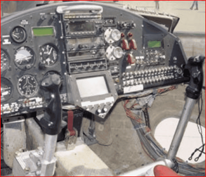

berkeman said:
Wow, what are all those buttons for in the lower right of the instrument panel?
5th picture down here: https://newatlas.com/go/2504/#p4014
Great pics! My guess are contact circuit breakers. Notice the wire bundle running under the control panel.

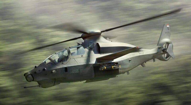

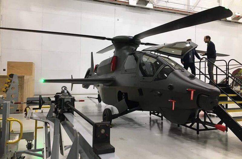

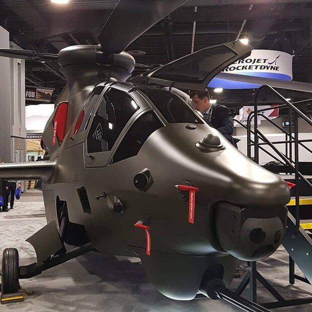

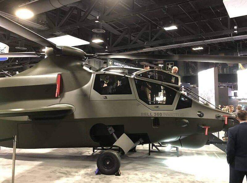

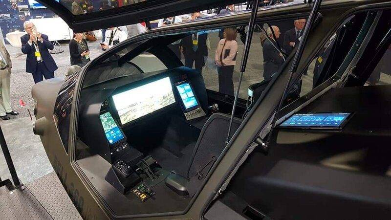

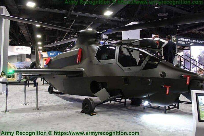

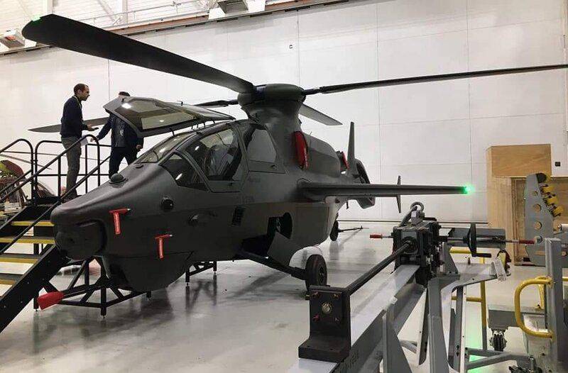

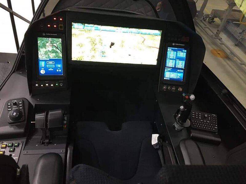

Technically we already have a supersonic helicopter (and airwolf) it's called The Bell 360 invictus... was made after the rah-66 Comanche. Here is some real airwolfs. Its not in the field yet but they exspect it to be by 2024.
330 km/h is a far cry from supersonic.
Likes berkeman
  • #31
@NCIS1996 this is a science forum. It's a good idea to have your facts straight before posting, 'cause folks WILL notice when you don't.
