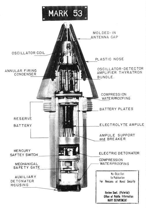

  • #31
I no longer work designing or operating real weapon systems but fiction and history are another story. My idea of embedding the OP's 'bomb' inside the RF device is a play on WWII proximity fuze.
From 1940 we see a continuous-wave radar system with RF generated by a thyratron embedded in an explosive shell hardened for massive accelerations. Proximity devices were so effective they should have been developed for ground transport back in 20th C. if not for security classifications.
[Edit: added picture from 1940. This gadget looks deadly.]
Yes it does :nb) (And I'm now on a tangent looking into these, just for fun.)
