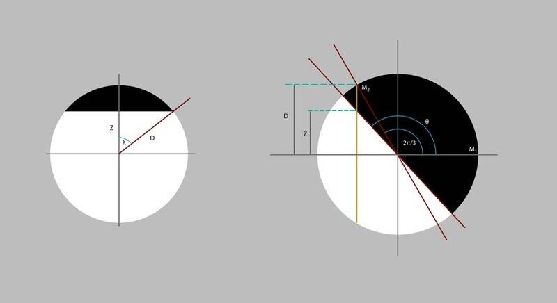

Thanks for the responses. But so far these answers are of the "just because" form. I am familiar with the theorem. Indeed, DrChinese, I've ready your own write-ups on both Bell and EPR in the past and found them helpful. But perhaps the central question was missed. The theorem is predicated on local hidden variables producing a linear correlation in measurement with regard to the measuring angle. Why is this so? I understand quite well that QM predicts a variable/nonlinear correlation and that observation verifies it. I understand that the proofs are thorough regarding the ways in which linear correlation =/= the types of correlations in measurements we see in QM. But specifically, why can there never be a LHV model which produces nonlinear correlations with regard to measurement angle?
Consider the attached image. It represents a scenario in which you are trying to measure the color of a point on a single sphere (which is divided in half into two colors and which is in a random orientation) and a corresponding point at some angle relative to the first point. A is the first measured point, B a the second, and C a the third. The angle between A and B is θ, as is the angle between B and C, with respect to a 2 dimensional measuring plane shown in green. The probably of getting a matching color on B is proportional to the portion of the circumference marked in blue which is the same color as A. If you run this for all possible alignments of D (the axis of the sphere) then you get the same correlation between A and B and between B and C, but because the portion of correlated points on the illustrated circumference does not vary linearly with the angle difference, you will find that the probability of correlation between A and C varies nonlinearly with respect to θ.
The candidate local realistic model doesn't have to be linear at all. You will notice that was not one of the criteria I supplied above. The reason anyone mentions the linear issue is such models most closely match QM. But you CANNOT have ANY realistic model that matches QM (unless of course there is a non-local component).
So you will see that your example cannot be both realistic and match QM. Again, try to generate triplets at A=0/B=120/C=240 degrees and you will see it cannot be done. And don't forget you need perfect correlations too! So AB=BC=AC=.25 (or .75 depending on whether you are modeling Type I or Type II PDC). The best you will be able to do is AB=BC=AC=.333 (or .666).
Normally, when this subject comes up, the first thing you want to do is to ignore the realism requirement. That requirement is, to be precise, the idea that counterfactual outcomes can be presented (i.e. you can provide an value for any hypothetical measurement). Then the locality requirement is that such outcomes are independent of actual choice of measurement elsewhere. What Bob chooses to measure does not affect Alice's outcome.
If you deny that counterfactual outcomes exist, or need to be supplied, then you are simply accepting the standard viewpoint and agreeing with Bell.
Or to put it another way: the linear idea is not a stringent requirement. More anecdotal than anything. It is absolutely not part of the formalism. So objecting to that is not an undercut to Bell.

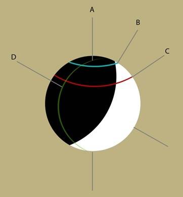

Again I'll have you look at the attached image. Continuing my model of a sphere having any possible orientation when entering a measuring apparatus. M1 and M2 are the points of measurement, 120° apart. θ can be at any value, and given a value for θ, the probability of M2 matching is equal to the proportion of the circumference drawn by the yellow line (and shown as a cutaway to the left) which is of a color matching M1, namely Pr = 2λD/2∏D = λ/∏. So to find the total probability of correlation you would sum up this way for all values of θ and divide by n. Given my diagram: λ = aCos(tan(∏-θ)/√3). This works out to an integral which is a bit beyond me... But I can at least do an approximation by taking a handful of values for θ and averaging them. Taking increments of ∏/12, I summed Pr from θ = ∏/2 to 17∏/12, and divide by n... I came out with about .23275.
so... what am I missing? The key difference between what I'm suggesting and the example you use is that given the spherical geometry, the proportion of possible correlations to anti-correlations varies nonlinearly as θ. This doesn't match QM exactly, but that isn't my point. If using a spherical interpretation can generate an unexpected prediction, then how (and please be thorough) can we be sure that no one would ever discover an lhv model which matches observation?

so... what am I missing? The key difference between what I'm suggesting and the example you use is that given the spherical geometry, the proportion of possible correlations to anti-correlations varies nonlinearly as θ. This doesn't match QM exactly, but that isn't my point. If using a spherical interpretation can generate an unexpected prediction, then how (and please be thorough) can we be sure no one would ever discover an lhv model which matches observation?
I have to ask... Have you read bell's original paper? It's online at http://www.drchinese.com/David/Bell_Compact.pdf.
All this discussion of whether the correlation is linear or not is besides the point, as Bell's argument is not "predicated on local hidden variables producing a linear correlation in measurement with regard to the measuring angle". Indeed, in the discussion leading up to equation #7 in the paper, Bell shows how a local hidden variable model can lead to a cosθ relationship between measurements; and with your ball you've constructed another lhv model with non-linear correlations.
Instead, the flow of the argument is roughly as follows:
A) If we assume the truth of equation #2 in the paper, mathematical logic leads us to Bell's inequality.
B) Quantum mechanics, under some circumstances, makes predictions that disagree with Bell's inequality.
C) Therefore, if QM is correct, then the assumption behind equation #2 in the paper must be false.
Now that experiment has verified the quantum mechanical prediction, we pretty much have to admit that equation #2 in the paper is not correct. Thus, LHV theories have only two ways forward:
1) Find a flaw in the experimental procedures, in which case maybe equation #2 has not been proven false after all. This leads us into the endless (and increasingly futile) search for "loopholes" in the experiments.
2) Find a theory that doesn't imply the truth of equation #2, but that would still be generally considered a realistic LHV theory (an informal definition would be "would have satisfied Einstein, Podolsky, and Rosen"). This is a very tough challenge, as equation #2 is pretty much a restatement of what an EPR local realistic theory would be.
(There is room for endless discussion about exactly which classes of theories are excluded if Bell's equation #2 does not hold in general... and I have no doubt that this thread in general, and this post in particular, will provoke more of this discussion... But that does not change the fact that a broad class of theories are excluded, including all those that would have been generally accepted as LHV in the pre-Bell world).
And I will again tell you the same thing. You are leaving out realism!
You can hand pick the values yourself, and then build a model to suit. But it won't make any difference because the values will still not be able to match an observer independent model. Clearly, you cannot have an expectation of .23275 for the angle settings 0/120/240 degrees. If you have 0/120 match that percentage, and 120/240 match that percentage, the likelihood of 0/240 matching will be something like 50%. Oops, that means it is an observer dependent result because it is dependent on which pair is actually being measured.
To help you see this, and I will use the QM value of .25 instead of your value of .23275 to make it clear:
0 120 240
0/120 matches 25%, 120/240 matches 25%, so all good. But when that happens, you end up with 50% for 0/240 matches! That means it is observer dependent and therefore no realistic. Once you adjust your model to be observer independent, your best ratio will be .333.
Now I know what you are thinking, "my model IS observer dependent". Well, sorry, no, it isn't as I am showing you. The test I have given above is standard. If it is realistic, you must be able to produce values for any angle setting independent of which other is selected.
By the way, there have been a number of attempts to exploit ideas like yours to produce a local realistic model (of course they all are failures). See for example Caroline Thompson's "Chaotic Ball" model.
